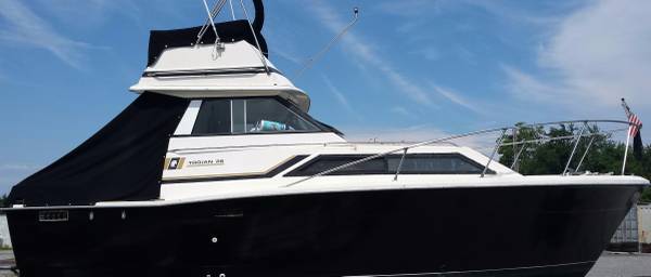

$5500
lunkerbasserfishing
Posts: 23
Joined: Tue Apr 11, 2017 1:02 am
Re: water damage?
Post by lunkerbasserfishing »
$4200
black hull.jpg (16.26 KiB) Viewed 11985 times
Re: water damage?
The only reason to buy and fixup this boat is because you want to buy and fixup a boat. Otherwise, heed the advice above. Boats that are already in service provide plenty of opportunity for projects if you want to work on project. Oh, and in the meantime you can go boating!
