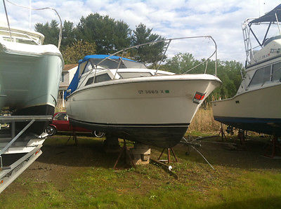

Well i put her back in the water around noon yesterday floated her for 3 hours then started moving up the river after about 10 minutes under way when things were nice and warmed up that's when I gave throttle and found this out and since I'm a chicken I only tried it once and for less than 10 seconds backed off and no more noise at all so just went 1 hour up the river to the marina at about 6 knots. I'll look for collapsing mounts and find a tutorial on shaft alignment and report back later today I will keep checking this thread though in case there are other ideas. The picture is how she sat for all those years until I got her.

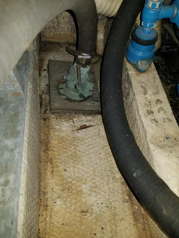

Prowler all four mounts look in the same shape as the one in this picture basically look new. Also since I'm posting this picture anyone have valves like these and if so how do you know which way is open? Haha I just hijacked my own thread.

Groco SV Series valve. That one is almost completely open. Best bet is to pull the rubber "plug" out when the boat is out of the water and grease it with a non petroleum based grease. Good valves but parts are non existent. Pretty easy to do.

Thank you diverted it's got a lock screw on the backside that I like you can set it open or closed and know it won't change i just couldn't tell which position it was in I just knew I had water flowing out the exhaust so it must have been at least semi open.
