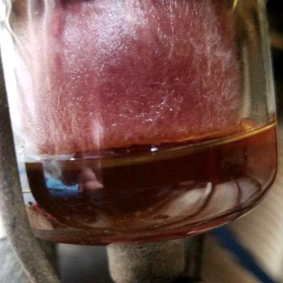

Well the guy I got the boat from said it sat 8 years I thought he was exaggerating since I fired up the boat and ran it after I bought it just to make sure it ran and it did just fine. Went to change the fuel filter since I am just performing standard maintenance getting it ready for the water. I thought the filter housing glass was tinted until I poured it out so i changed the filter cleaned the bowl and reopened the fuel petcock and the line drained back in this is the gas that was in the line and it ran off of I've never seen gas this dark before I'm impressed the chrysler 318 burned it.
- rps20170725_132315.jpg (34.49 KiB) Viewed 9127 times

I took it apart and filled it with clean fuel again and changed the water seperator filter too so now there's clean fuel in the lines but it would seem I've messed something up the filter bowl won't stay full any ideas?

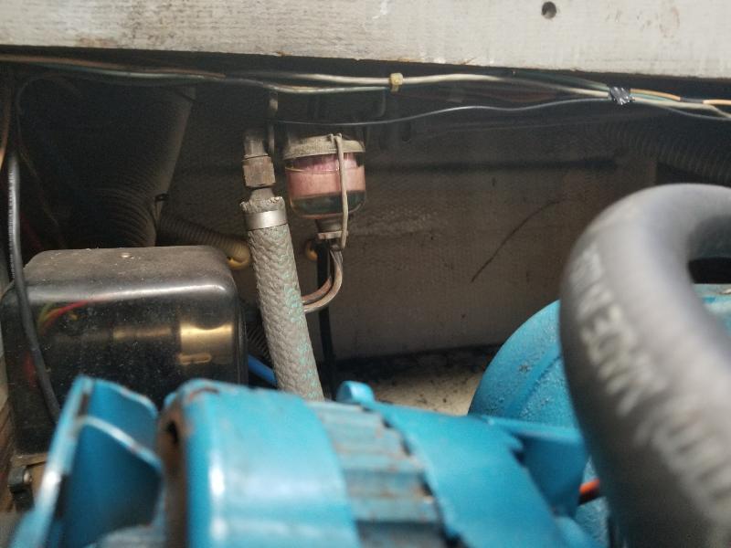

Here's the picture sorry for the delay.
- rps20170807_160115.jpg (49.62 KiB) Viewed 8940 times

Re: Changed fuel filter today oh wow.
I think you definitely need to replace that with an all metal fuel filter.
That is exactly the type of sight bowl used on a MerCruiser engine's fuel pump to indicate pump failure. It looks like some where along the way someone added filter media to it and installed it inline.
I'd recommend replacing it with something like this primarily for safety reasons but also for efficiency.
https://www.westmarine.com/buy/sierra-- ... cordNum=18
Hope this helps
