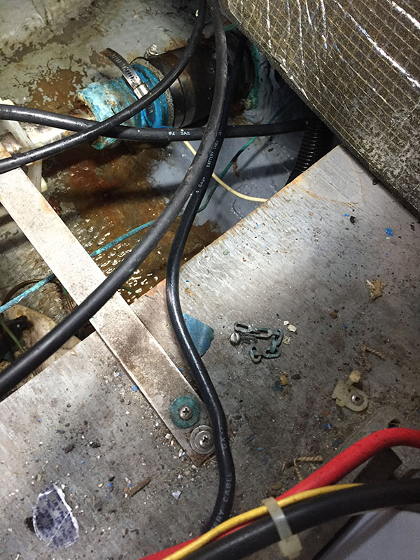

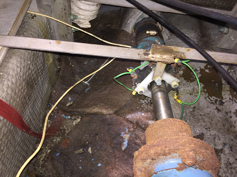

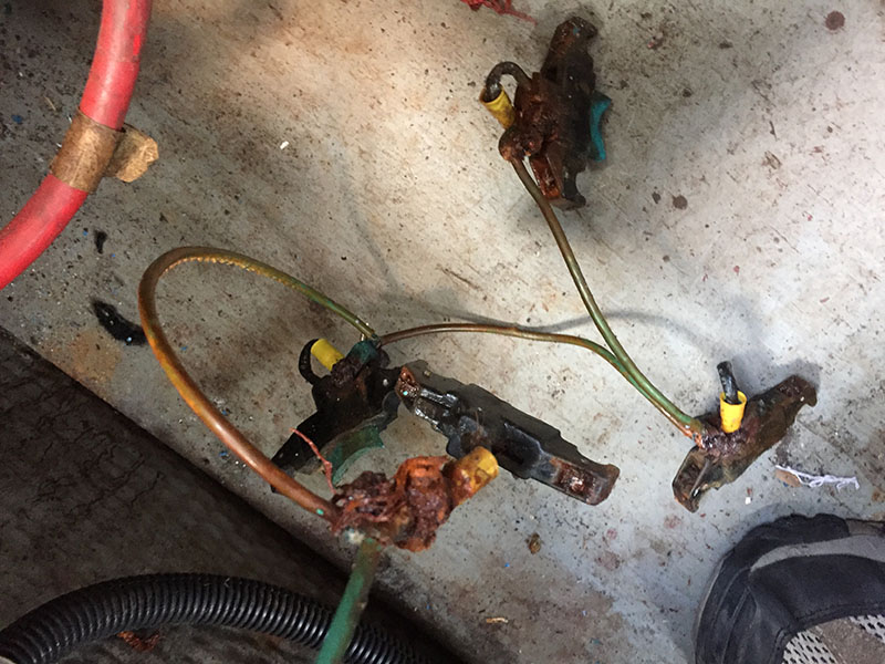

Okay it looks like I found the leak and you guys were right it is coming from the "shaft area" the starboard side shaft has a quickly dripping, to slow running water leak. It is dripping from the left (in the picture) bottom side of the hose clamp probably from the deteriorated end of that green cuff, then back under to where it drips into the bilge. And as I said, I am a beginner and I don't even know if that is the "packing" area or not… I also noticed that the apparent grounding system for the shaft, which is in place on the port side, was laying in the water below the shaft and is a all rusty.
So… Due to my limited, or I should say, no mechanical skills (I almost killed myself just taking these photos!) I am going to hire a mechanic to remedy, probably both shafts, so I start from the same place on them.
Prowlersfish... The front bilge pump comes on for approximately 20 seconds every three hours.
So, I think I am looking at a mechanic for the shaft thingamajig and an electrician to replace the ground/bonding thingamajig. Any further advice or explanation regarding the photos or how to phrase, or explain it to the mechanic and electrician would be greatly appreciated! And again, thank everyone for their input so far… Jim

That's a ground? Looks like a sensor of sorts. Glad you found your source no one wants to see the top of their boat from the parking lot.

Those appear to be part of a shaft grounding system. It would have been added by a previous owner as extra protection against stray marina current. Whether you need it or not would be a question of how fast the underwater metals are damaged. Think of it as a lightning rod for underwater to protect against galvanic corrosion. Not absolutely necessary, but extra insurance, just in case.

I am shocked the surveyor did not say anything about this . What the gizmo is a brush set up to keep the shaft bonded to the boat . Definitely seen better days . If this was My boat , I would remove them make sure I had zincs on the shafts and be done with it . Others may disagree. But if want to keep the system there are simpler set ups that can be used . As far as your leak it looks like you found it
.https://shop.hamiltonmarine.com/product ... 26718.html
