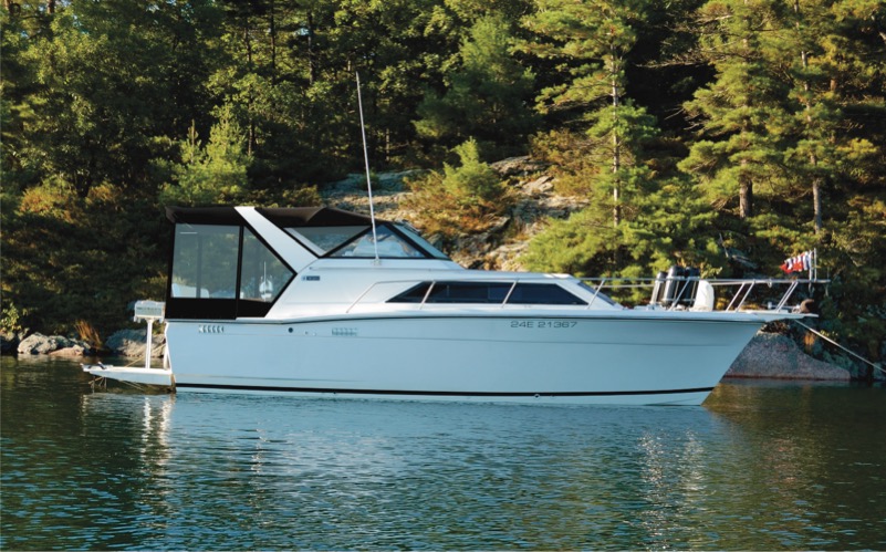

Gotta do it....can't put this off another year. Time to start making the mold.

Hi Paul, is that a photo shopped picture of your idea, or another boat, either way that is super cool and a modern/functional way to hang canvas.
I wonder if that would work on a Tri Fly?????

Hi Barrie, yes I photo shopped the arch onto a photo of my boat.Barrie wrote:Hi Paul, is that a photo shopped picture of your idea, or another boat, either way that is super cool and a modern/functional way to hang canvas.
Have been playing with the concept for years now...I think it suits the overall design/ lines of the F Series Express.
I will be sure to post a pictorial over the course of the project. Hoping to start Mid-Late November.

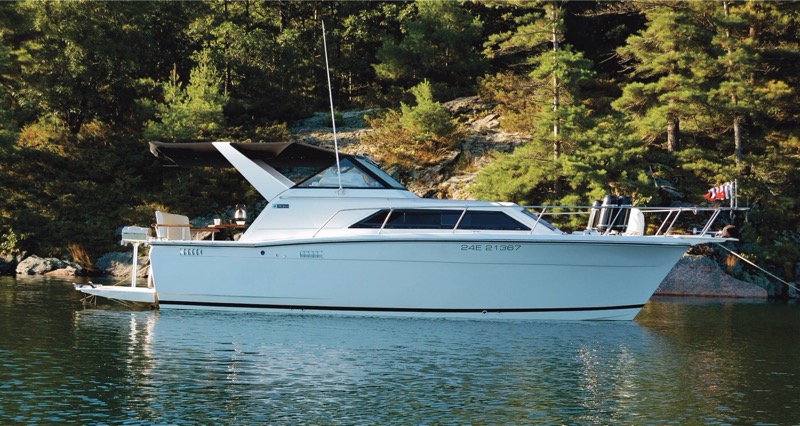

After many hours of deliberation, the decision to go the fiberglass route is out the window.
Never been one much for conformity...so I've completed the designs for an all aluminum arch. Fully skinned without the exposed tubular look seen so much these days.
The arch will be finished in white.
Below is the look with the enclosure panels. All the canvas edges that meet the arch will be hidden behind the outer aluminum skin and attached using welting cord and white flex awning track. No snaps as normally used.

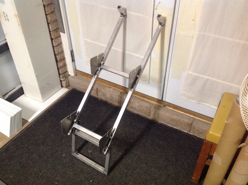

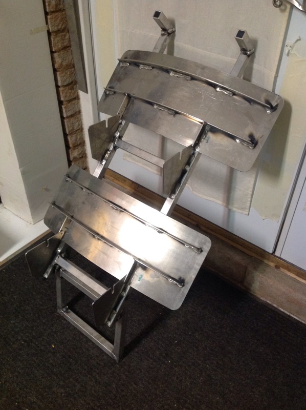

Designed & built this folding companionway staircase for my Sailboat using 0.125 and it is very strong. No warping problems with this during the welding process, so we'll see with the arch.
Yes...it will be powder coated white for the finish. Seen a lot of stuff over the past 10 or so years that has been powdered coated, yielding excellent results.
