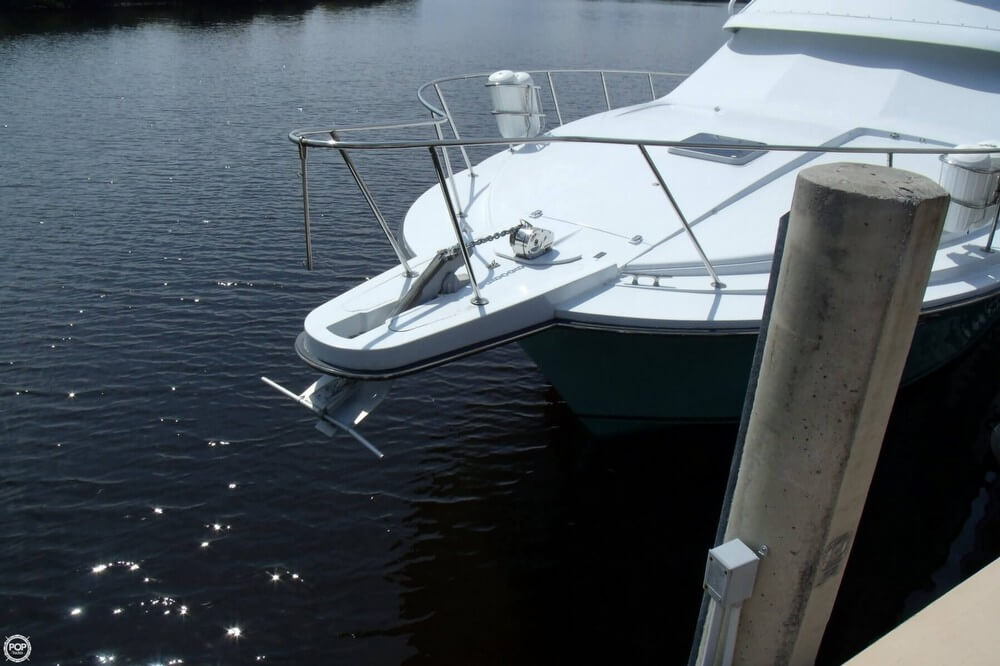

Mine is mounted only on the pulpit (covering some of the teak) so that the anchor locker is still functional. On a lot of the 10 meters I've seen, the windlass is mounted farther back and directly on top of the anchor locker hatch making it unusable. I guess to compensate, I have also seen access hatches in the v-berth behind where the mirror is normally mounted. I don't have that on my mid cabin and would certainly install one If my topside hatch was covered (I guess you would have no choice).
I'm happy with my setup but it's rode only, I have about 15' of chain which sits next to the windlass. Like a lot of people, I felt like I was stuck with the "footprint" of my existing windlass because of all the prior holes drilled. If I were starting from scratch, I would definitely go with a rode/chain setup. I too rebuilt my pulpit so thinned epoxy is key to seal all of the new holes you'll be drilling. And, oversize the wiring because it's a long run (roundtrip) which is the correct way to calculate.

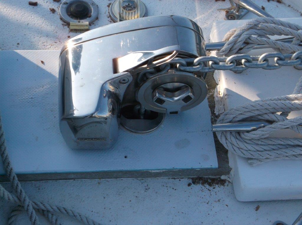

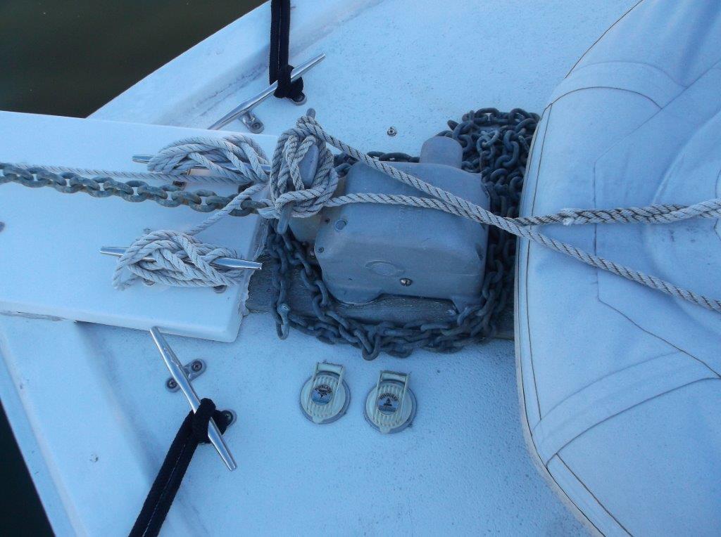

I really like my Lewmar Pro 1000 . I was going to go with the profish 1000 But I got a hell of a deal on the pro (1 year old take off ) and planed on adding the free fall kit . Well the down is so fast I don't see the need for the free fall it faster down then my old good free fall . Now the Good is a great windlass and I would have gone to the F850 chain/rode But the price stopped me . I sold the 40 year old Good CDF for more then I paid for almost new Lewmar pro1000 While a Good is a some what better windlass . The Lewmars are far from junk and look better too .
The reason I changed over was so I could use chain . I use to add a section for over night on the hook . Now it on the rode
