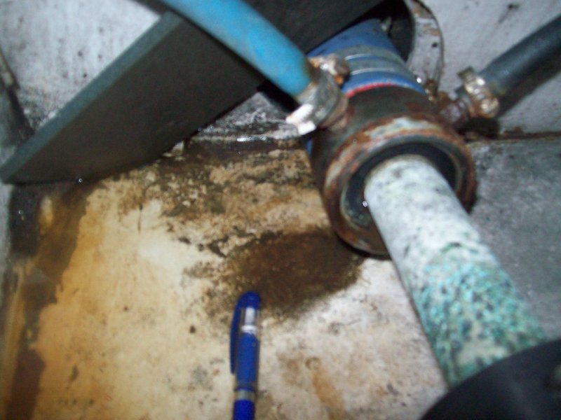

Present dripless isn't dripless, in fact one shaft is leaking quite a bit. Will have it hauled after we get more acquainted with the boat and able to include anything else that is fixable at haul out. Intend to remove dripless and go back to standard old packing. Note there has been improvements in the packing material and am not comfortable with what I see in the attached picture.

regarding the photo in this thread, please tell me those are NOT the factory 1.25" shafts behind those Cummins...…..

RWS, they are 1 and 1/2. But note you posted about trim tabs with your yanmars. As I noted out boat had the trim tabs removed. Thinking about putting some back on. Seems to be a little nose high in cruise mode, You noted didn't help your speed but could change attitude. Cummins heavier than your Yanmars but would like a lower nose attitude for cruise. According to Boat Diesel calculator using 18,000 displacement cruise seems to be in line with what i am seeing so don't know about adding trim tabs. Your thoughts.
