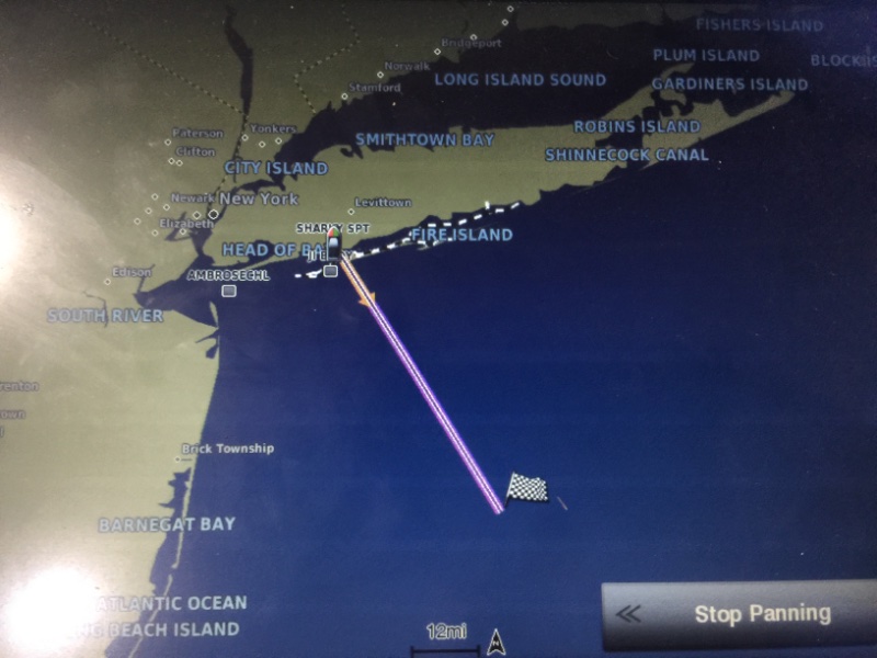

We took the boat off shore for the first time this Summer, it was a beautiful day and an awesome trip
About 40 miles South of Jones Inlet

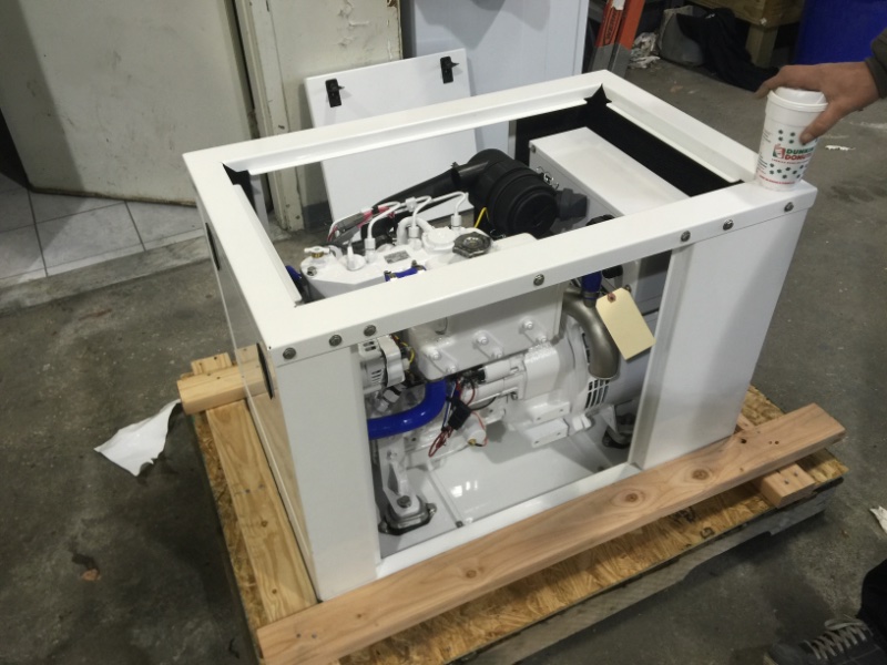

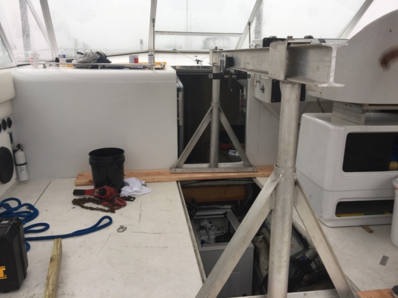

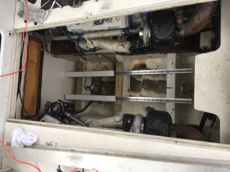

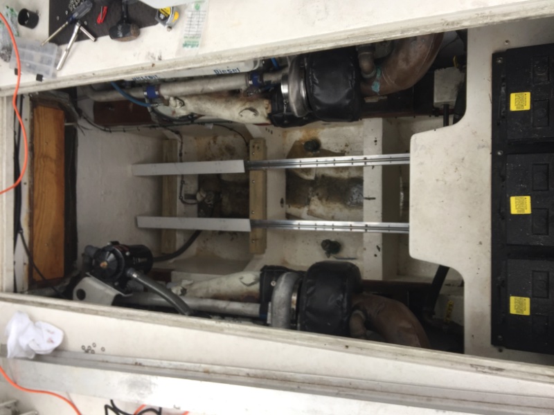

This was a big upgrade for the boat
9.5 kw Phasor Marine w/ a Kubota engine
It’s a really tight fit between the Detroits, and very difficult to do maintenance on everything with the geni there so I installed it on rails

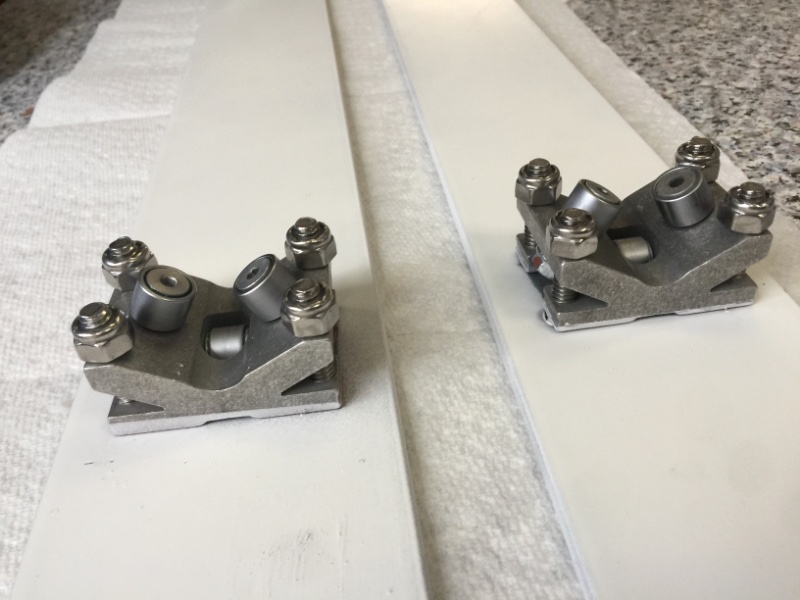

These are roller blocks that go on the rails
- 6F7E7C99-4F77-4C6A-B2C2-ACF7101DCED8.jpeg (120.49 KiB) Viewed 12048 times
- 6CFE499B-C11D-42DA-9C05-09E86C956B3A.jpeg (107.24 KiB) Viewed 12048 times
- DD3C42E6-5EB6-472A-BB3E-33BE00CBF854.jpeg (109.09 KiB) Viewed 12048 times

I spent about $9500 for the geni and hush box with freight
$2500 for rails and roller blocks
$500 for hardware and exhaust
Absolutely worth the extra money to be able to move the geni
I am 6’1” and I can sit in the bilge in front of geni for maintenance

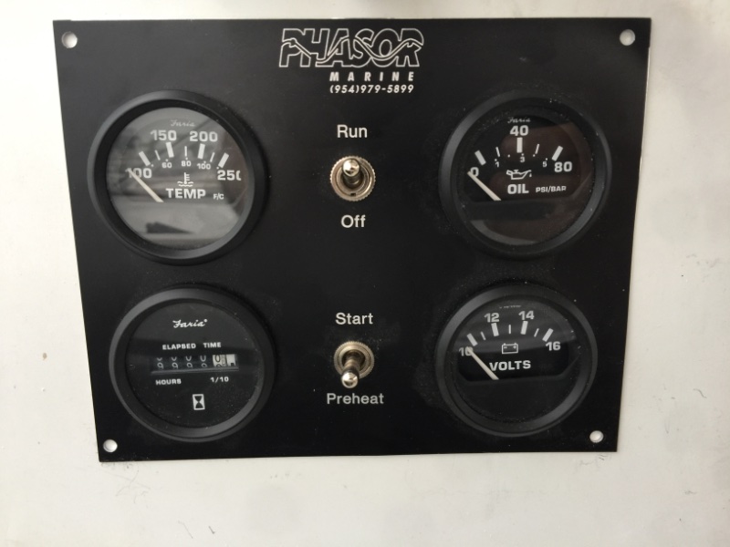

I bought the remote panel, it worked out great and is very easy to watch the gauges
