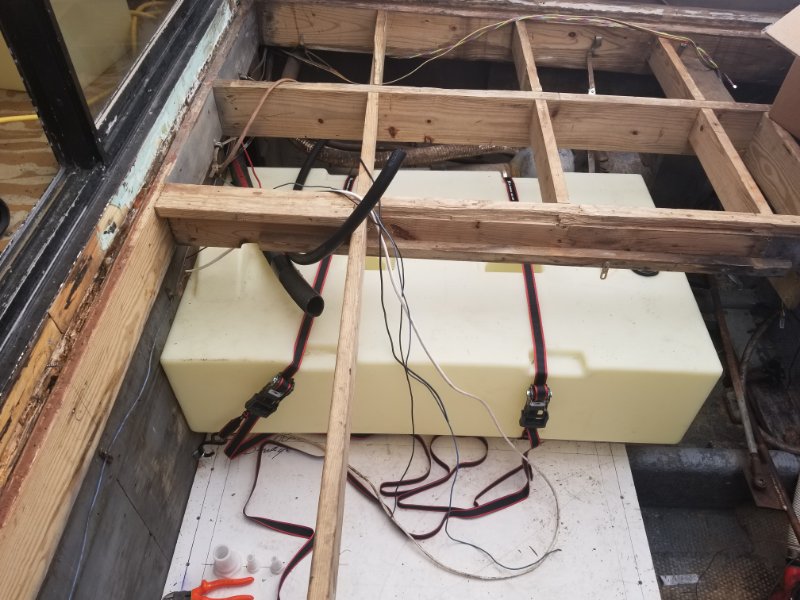

Here are some pics from today.

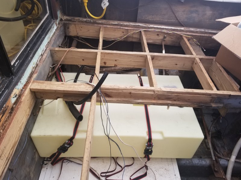

More pics
