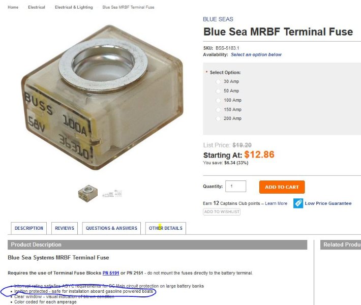

Its hard to meet the ABYC 7" guidance without using this type of fuseholder: https://www.bluesea.com/products/2151/D ... 30_to_300A
Example of fuse:
