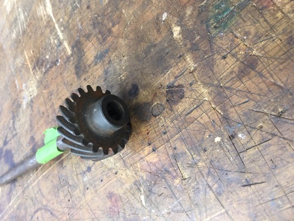

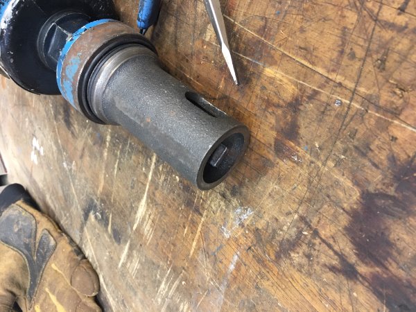

Check the gear on the intermediate shaft...... seems to me there was a roll pin.....perhaps the pin is broken.
- Posts: 25
- Joined: Wed Sep 18, 2019 9:15 pm
Re: 318 no oil pressure
The standard rotation shaft has a pin. This one seems to be pressed on. I placed it in a voice and attempted to turn the shaft with a wrench. It didnt move. I'm wondering I'd I just need to let it run a skotch longer. I'm gonna try that this afternoon. I'll post how it turns out.

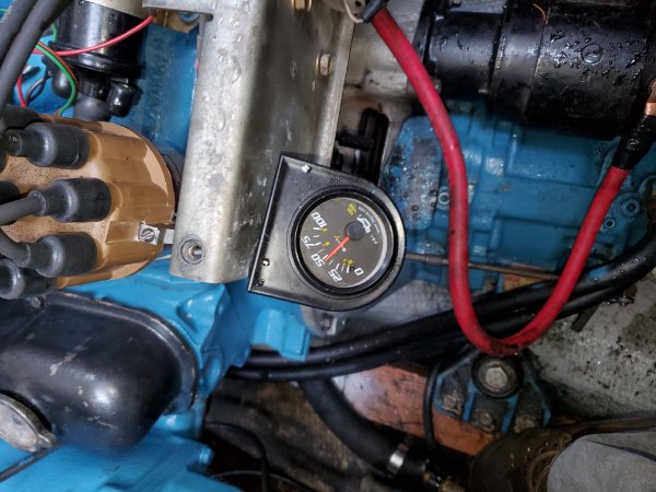

Get this, the lines on my remote oil filter set up were switched. It was fine when I got the boat 2 years ago. And fine at the beginning of last season. I think I was sabotaged. Because the only thing I did with it was change the filter. I never messed with the lines. So, I removed the set up amd put the filter right on the block. I had changed the filter a couple times thinking I had a bad filter, but 2 in a row isnt common. On a whim I pulled the filter amd barely any oil came out. That's when I figured it had to be the issue. When I put the new filter on and started it I got 45psi. I feel like a moron but there were 3 other mechanics that I am friends with trying to figure it out.
- Psi at 1500ish
- 20200406_175224.jpg (69.59 KiB) Viewed 9228 times
