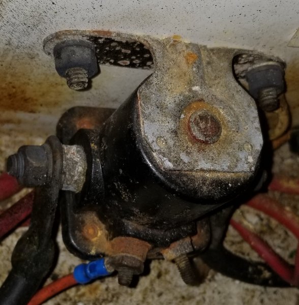

Looking forward to boating season. Except my port engine won't start.
I changed the solenoid on the starter as I thought it was the issue due to the following:
1) using switch at helm, engine wouldn't start, starter wouldn't engage, the beeping would just go silent, if held too long the breaker on the panel would release and I'd have to wait 5 min to reset the switch
2) if I jumped the solenoid with the helm switch on, it would start
Unfortunately, with the new solenoid in, it still won't engage the starter. And now the relay (see picture) in the battery box clicks when I jump the solenoid and the starter doesn't engage.
Any thoughts or suggestions would be greatly appreciated, I'm stuck, and want to get out to enjoy isolation on the water.
Cheers,
T-Dogg
1987 Trojan F36 Tri-Cabin

That solenoid/relay is for the system that jumps the batteries . The problem may have been the neutral safety switch . But now it sounds like you have a starter solenoid issue too . Bad part or a Install issue ? So likely 2 problems to diagnose and fix .

prowlersfish wrote: Mon May 25, 2020 7:15 pm That solenoid/relay is for the system that jumps the batteries . The problem may have been the neutral safety switch . But now it sounds like you have a starter solenoid issue too . Bad part or a Install issue ? So likely 2 problems to diagnose and fix .
The relay/solenoid in the battery box clicks when I jump the starter Solenoid. So if the neutral safety is faulty, the starter solenoid won't start, but if I jump it use to turn over and keep going. How would I test the safety switch?
