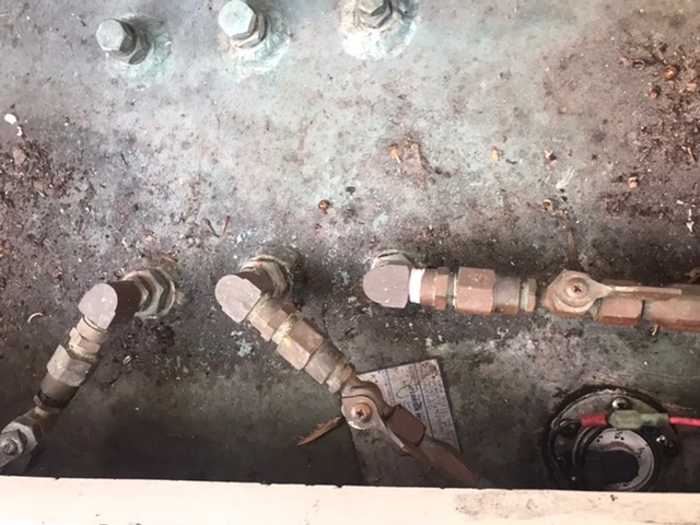

Getting ready to change my anti siphon valves. What is the best way to attack this? Do I need to remove the fuel line nut to be able to have the room to remove the valves? Do I need to use Teflon tape on the threads of the new valves. Any tips would be appreciated.
Re: Anti siphon valves
Line needs to come off as its on the anti siphon valve Teflon sealant in the male threads only
