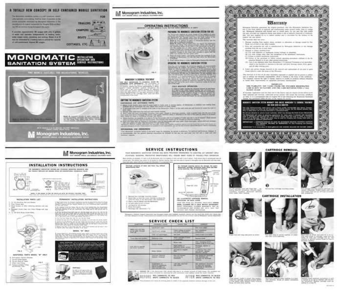

Sorry, your correct. mine is located under the steps from the kitchen to the lower birthing areas. Now for an update. I was able to hook up the water pump that it now fills the water heater, pumps water to the kitchen sink and the bathroom sink. But I have yet to find or figure out where the water line hooks up for the toilet. That is the only thing I do not have hooked up. The toilet has a water line and valve on it and it is open, but still no water goes to it. I was also told it can pump overboard or the waste tank. I don't know how or where you set it to do one or the other.
Ken
Ken
Re: Air conditioner
Do you have a owners manual ? It may have the info .
Re: Air conditioner
I do but it doesn't specify , I apparently have a monomatic toilet. I see a pumping handle in the closet. I am assuming that it goes to that toilet? Looking at youtube it doesn't really give me much of a clue. I don't see a water hookup for it, though that line runs into the pump. Does that pump fill the toilet? How and where does it evacuate?
Re: Air conditioner
I Had One of those . First boat project I did was get rid of it . recirculating toilet ? not on my boat
"The Monomatic is a self contained recirculating toilet. It has an internal maserator and circulating pump. It needs a "charge" of a gallon or two of water with a preservative chemical added. They work a lot like and airplane toilet."
- MonomaticToiletManualPagesAllMAIN.jpg (108.92 KiB) Viewed 6466 times
Re: Air conditioner
So I simply dump a couple gallons of water into the toilet? when i flush it then I have to add water to it as well?
