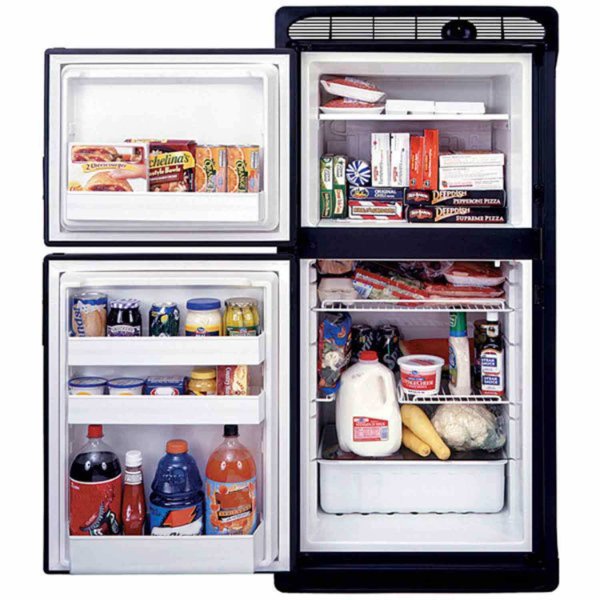

We have a Norcold AC/DC fridge. We run it off AC shore power and generator most of the time. On the hook, we turn the generator off at night, so it runs DC overnight. Draw is 3.2 Amps at 12 Volts DC, 2.2 Amps at 24 Volts DC, 0.4 Amps at 120 Volts AC. We like it and it has run well. Our insurance company will not allow propane on the boat, so that would never be an option for us for anything.
