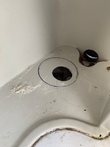

Has anyone run into problems with the fixed side (starboard) rudder/steering bracket becoming loose on the 10 Meter?
While running some new speaker wires yesterday I found sloppiness where the mounting bracket attaches to the fiberglass.
There is a good deal of slop in there now.
Access is difficult, but not impossible.
I am considering a deck plate, as I will likely have to fill and re-drill what I expect to find: an egg shaped hole, perhaps two.
Anyone been there done this?

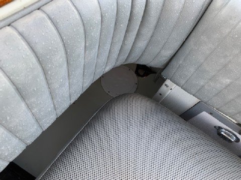

Access is through the removable transom inspection door and removable line locker.

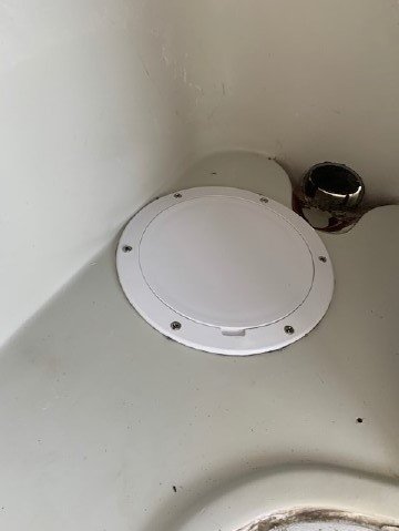

Additional access was created with a hole in the cockpit floor for a new deck plate, as close to directly above that attachment point as possible.
i AM UNABLE TO GET THESE PHOTOS IN THE CORRECT ORDER, but the captions are self explanatory.

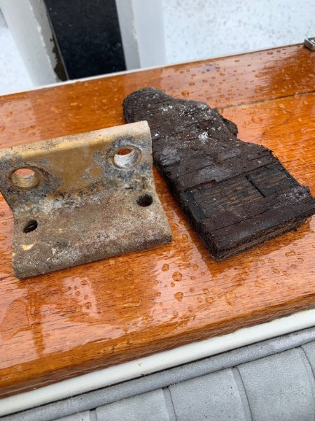

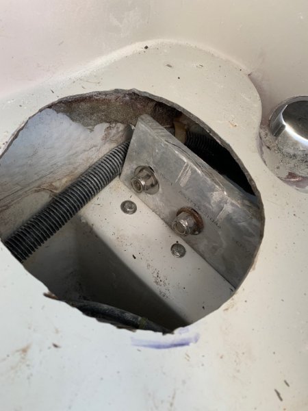

Basically what was done was to remove the factory above waterline plywood backing plate and replace it with STARBOARD.
Additionally, I added 2 through bolts to eliminate any future possibility to allow the new plate to wobble or walk, as the factory holes in the tower had become egg shaped from all the slop caused by the disappearing backing plate

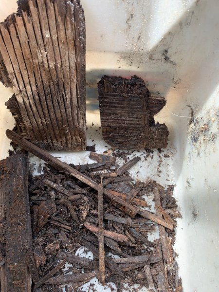

Scrape the old wood out with a sharp awl and putty knife, vacuum out with a shopvac
Keep in mind these re not in order
The pencil points to the additional throughbolts

What plywood didn’t fall out I scrapped out with a sharp awl and putty knife.
Replaced the plywood with starboard and added two bolts to insure it wouldn’t walk or wobble in the future.

- 38 YEAR OLD PLYWOOD BACKING PLATE SCRAPINGS
