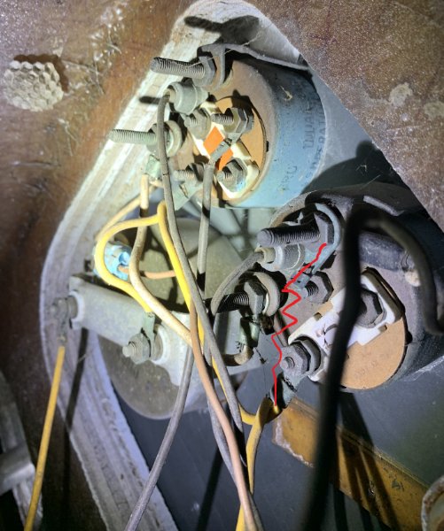

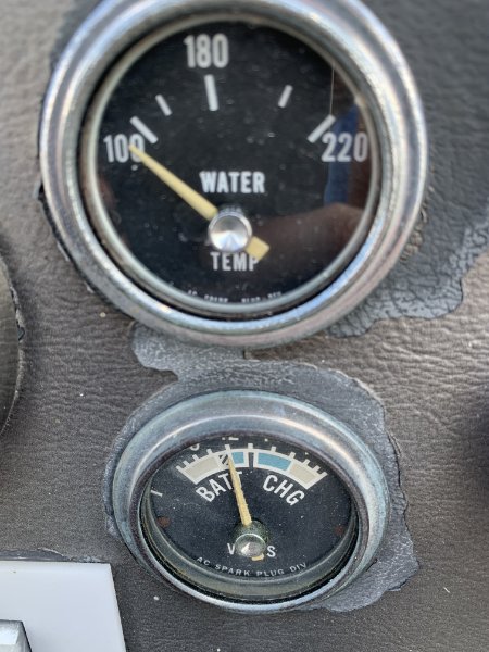

Helm gauges work fine. Any trouble shooting tips for Fly gauges? The RPM gauges register at idle, but do not increase properly on power... Ground issues? Connections are not new... I plan to crack open and closed all connections and see what happens from there. Battery and Oil pressure are DOA too.. Trying to figure out if I should mess with them or order a few new ones... Fly are Delco gauges, and Helm is Faria. I don't think a compatibility issue but maybe?( Yes new gauges will require new/good wiring too!) (Looks like a new ground will fix the bat gauge!)

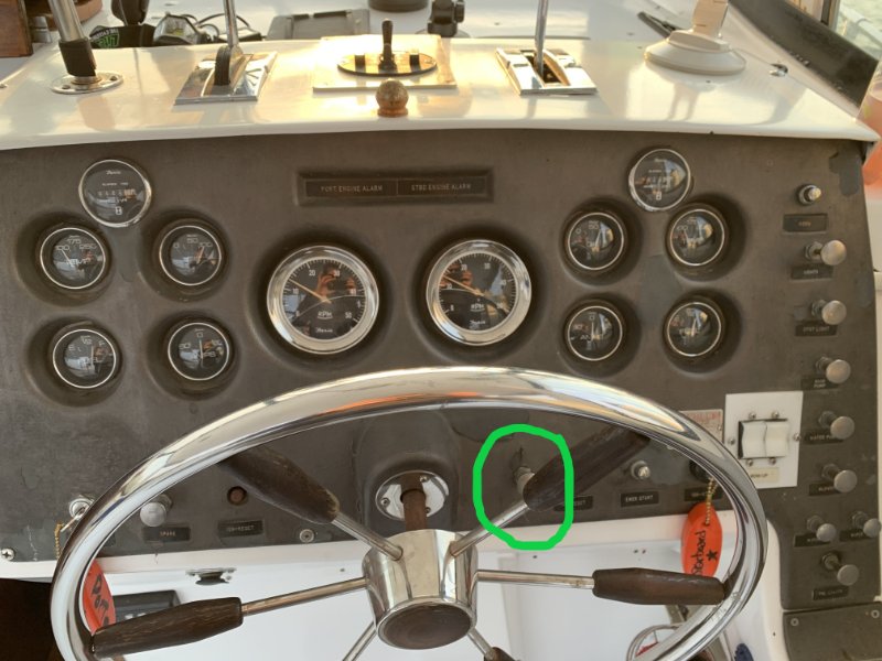

Also, anyone know what the switch to the right of the wheel is for? Need to get one of the kids arms to reach in there and ohm out and trace the wire... My guess is its a spare line on the port side of the wheel... But thought I would ask the gang! ( Incase you cannot read the other labes in the upload, it is not the (top to bottom) Horn, lights, Spot light, Bilge, Water pump, Blower, Wipers, or PnL Lights.)

Delco and Faria go not mix . Delco must have delco sender .( delco sender works only with delco) And on delco if you have upper and lower gauges they must be dual helm gauges .
On all others the gauge and senders must match . And with dual helm you must have a sender made for dual gauges .
Tachs and volt separate issue assuming its hooked up likely bad upper helms catch hell ,
