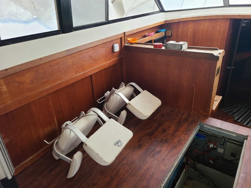

It's the rainy season and I've made it my mission this year to stop the leaks. Or at least the worst of them :wink:
I have a few obvious places to begin - properly fitting the flybridge panels in, re-caulking all the window trim, re-finishing the teak and caulking around the hatches, replacing the j-trim around the bottom edge of the fly-bridge.
I'm looking for some insight on the "not so obvious" places I should check while I'm at it?
The biggest problem areas I have are the starboard wall in the salon (pictured below with streaky teak), and the port corner above the galley (pictured below with colourful bowls to catch the water).

I've cleaned all the tracks (which were far more disgusting than I originally anticipated :shock: ) and peeled back and re-applied the caulking along the entire frame.
It's storming like mad here today so it'll be a good test :D
Boppy - I wondered about that! There is a small leak in the vberth on the port side. Currently my anchor is mounted directly above it, which I thought might be the issue. The deck is soft around there as well. That's another project once I am more confident in it remaining drier.
I'll be moving the anchor over the pulpit, and sealing those mounts up. I will add a dab of silicone to the rails screws as well.

The starboard wall fared much better this week after re-caulking and cleaning the window frame and channel. :D
The port side above the galley is still an issue, albeit a slower one. So my search continues here.
