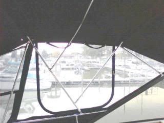

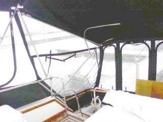

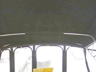

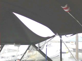

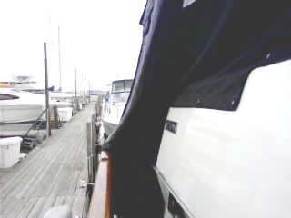

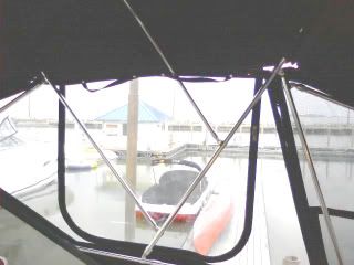

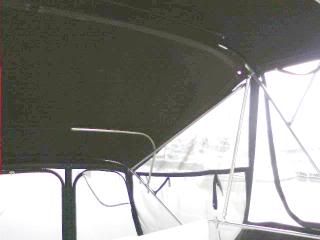

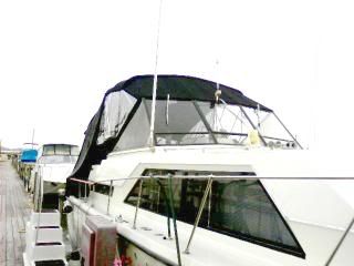

Took pics yesterday of my canvas. Comments & links below.
Front and side/back outside shots. Note how we board on the side. The panel above the swim platform ladder is a door. We plan on moving to a slip next season, keeping the boat backed in to the pier and employ getting on and off the boat from the back more:
http://i244.photobucket.com/albums/gg30 ... anvas5.jpg
http://i244.photobucket.com/albums/gg30 ... anvas4.jpg
Inside left & right front. Opened zippers so you can see how we can dump heat built up under the canvas:
http://i244.photobucket.com/albums/gg30 ... nvas12.jpg
http://i244.photobucket.com/albums/gg30 ... nvas10.jpg
Port & starboard side windows.
http://i244.photobucket.com/albums/gg30 ... anvas6.jpg
http://i244.photobucket.com/albums/gg30 ... nvas11.jpg

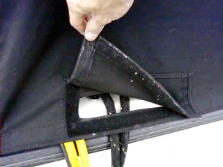

Details of the side, how it comes across the walkway, and a velcro'd flap for lines (should use more, but as you can see, don't). Getting in & out this way is narrow and awkward:
http://i244.photobucket.com/albums/gg30 ... anvas1.jpg
http://i244.photobucket.com/albums/gg30 ... anvas3.jpg
http://i244.photobucket.com/albums/gg30 ... anvas2.jpg
Finally, across the back, starboard, back, port. You'll notice the diagonal support bar along each side. That further makes it awkward to board from the side. You have to duck under it. When the weather is nice, we take off the whole panel & move the staircase back, but that bar is still an annoyance. If you were to enclose your cockpit, I'd recommend a different arrangement of the support bar and installing a door in the side panels for boarding from the side.
http://i244.photobucket.com/albums/gg30 ... anvas8.jpg
http://i244.photobucket.com/albums/gg30 ... anvas7.jpg
http://i244.photobucket.com/albums/gg30 ... anvas9.jpg
As for rot in the back, the previous owner had taken care of issues on the back starboard side. His father passed away in '06 and in dealing with other issues, he didn't do a good job of laying the boat up for the winter. It took a lot of water in the back port side. His insurance paid for some of the repairs, including a new door to the aft cabin. I took care of replacing the port side back wall of the cabin (the bump out for the bed) and the blocks for the swim platform bolts on that side. Although the insurance paid for the hatch repair on the cockpit floor, it was restored to its original condition, which had a finger hole for pulling it up. I eliminated that hole by installing a flush mounted SS pull ring. Enclosing the cockpit has eliminated justt about all water getting back there.
I just keep learning more and more! A friend of mine and I went to the boat this morning and he showed me where my oil coolers were. Ahh, so that's what those mahosckers are for; I was wondering about that!!!
