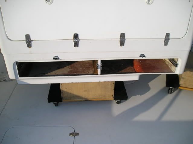

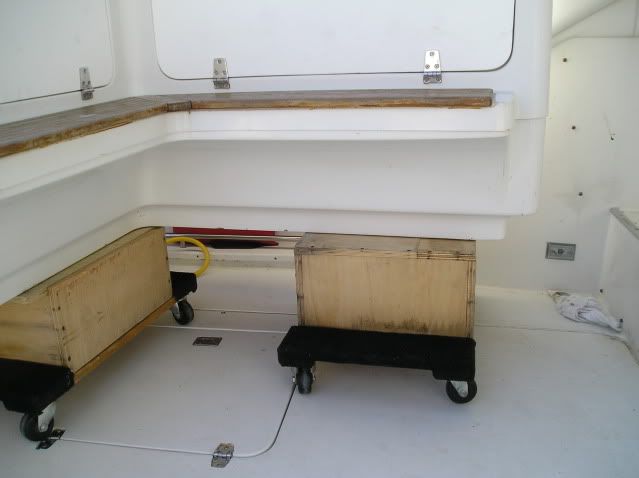

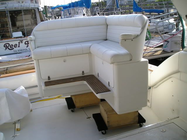

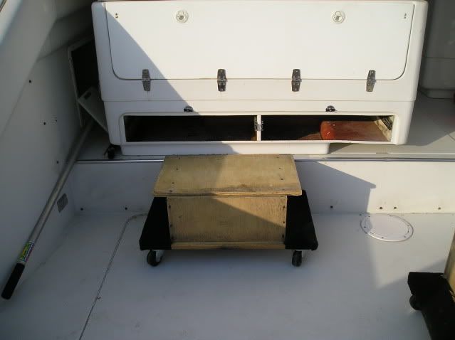

Our 11 meter has a L shaped seat on the port side. We needed to move it to get to our engines. I wanted to move it without unloading it and having to put it down in the cockpit. This is what I came up with. We have used them for several years now and they work great. They are made of furniture dolly's and a 3/4 plywood box that sits on top and is a snug fit to the furniture dolly. When they are not needed I store them at home.
Now when you have to put it back in place one does not have to lift it a great distance.
