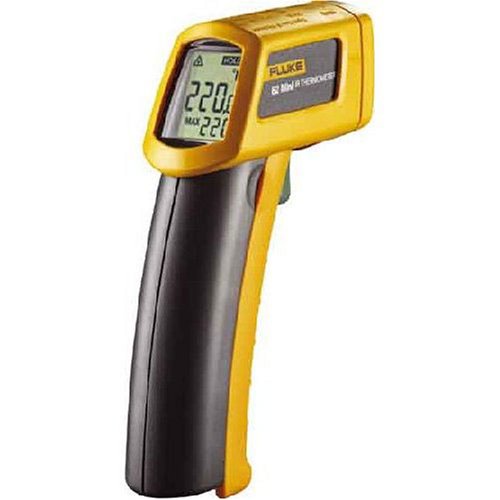

And you thermostats and gauges may not be very accurate.
You can by an InfraRed Thermometer for < $100 to measure exact temps and calibrate (even if you just make mental corrections) your gauges ...
The Fluke 62 is $89 with FREE SHipping on Amazon ...
http://www.amazon.com/Fluke-62-Mini-Inf ... B000MX5Y9C
