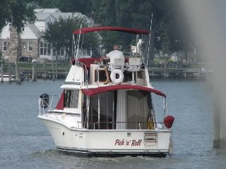

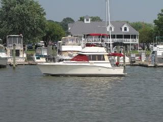

I also got a few shots of your neighbors Sunday....sorry, wasn't trying to take over the tread

No biggie Will. I enjoyed the pictures.....HEY, WAIT! I just hijacked my own thread!
