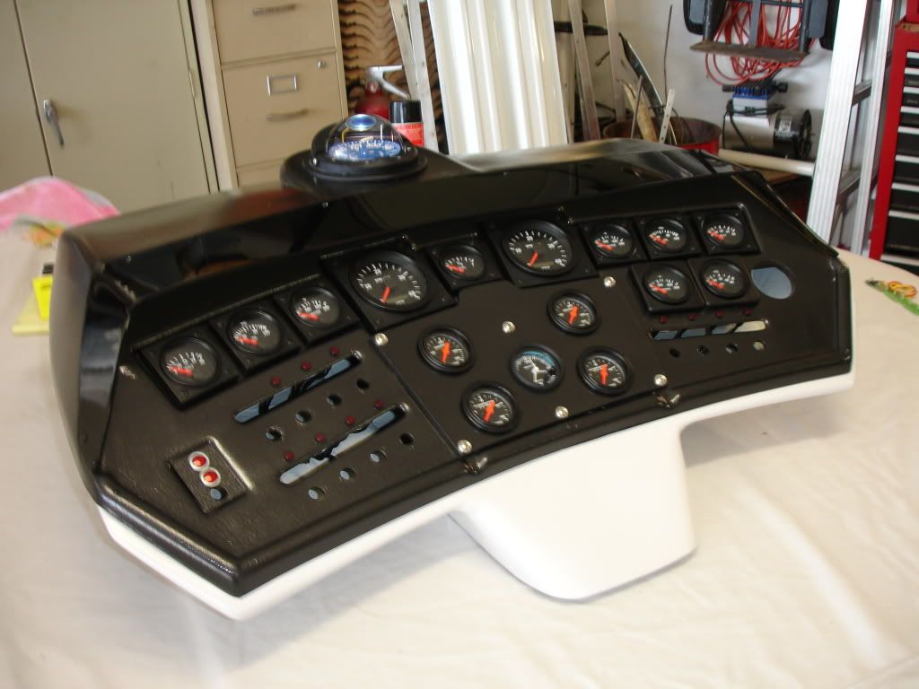

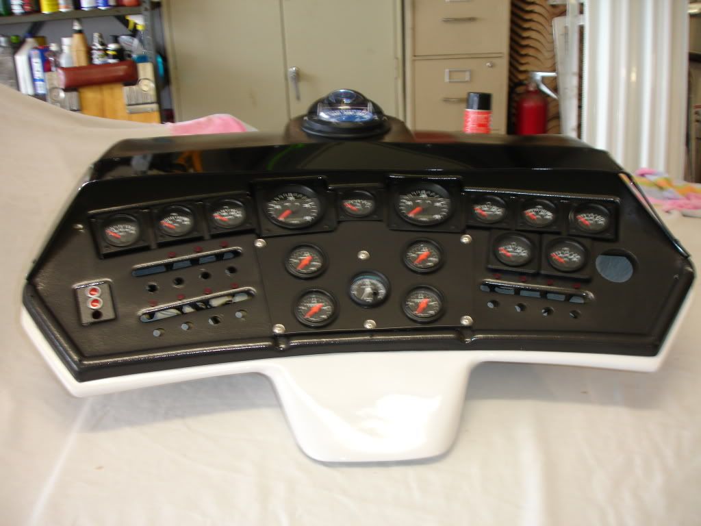

To be honest, I just bought the 4 in 1 gauge because it's less money for fewer gauges. The reduced clutter turned out to be the real benefit. When the summer comes and days are long, I'm going to start some projects on my F-36 again. I'm going to completely paint the ol' girl, do the lower helm like the bridge helm and rebuild the stateroom layout.
Reinforced & restored the factory panel.
Modified with a 1/4" hurricane shutter to accept pyrometers & boost guages.
added analog clock in center
photos follow
