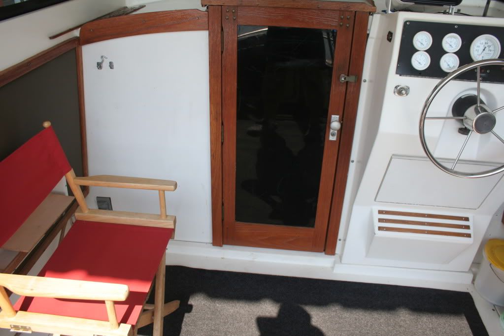

Brian,
I hope I have placed a pic of the cabin door (outside) I just finished on the boat.
I have just started bring home individual pieces of the teak wood to finish the work at home. When I get that done, I will start inside tha cabin with Cetol Gloss, taking the doors off, in the cabin, taking them home and doing work there also.
I took the door off where the stove was stored, to install a microwave and used it to test the Cetol Gloss with. I didn't take any care to prep it as it was not going to be replaced. But much to my surprise, it looked great.
Larry

BTW that cabin door looks top notch. If anyone has any photos to share, please do so. I find nothing more inspiring than seeing finished (or before and afters) wood refinishing work.
Brian
