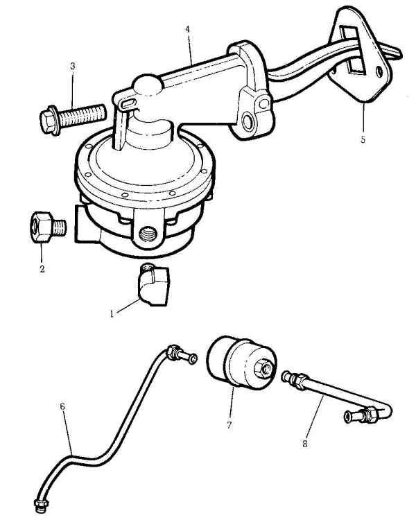

Does it look like this, number 7? If so, the Chrysler number is 4142597 and available at http://www.marinepartssource.com You may be able to get a Napa dealer to cross reference to another...

Thanks everyone for the help. I emailed Hurrikain about availability. I have found another solution for my situation and thought I would share it. I used a GM fuel filter ($12) and a $2 adapter and it works perfectly. Below is the setup:
AcDelco GF90 fuel filter (long GM # is 5650677)
Edelman #124520 5/16 inverted X 1/8 Inverted brass fitting.
(got these at my local Carquest Auto parts store)
If we/I could find a fitting that was 5/16 inverted on one end, and metric (14mm x 1.5) inverted on the other, then we could use the hugely popular and even cheaper GF481 or GF652 AcDelco fuel filters.
