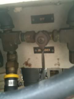

Can anyone tell me what this means? It is the fuel crossover switch. Is it on or off and how does this thing work? I see the generator feeds from the starboard tank. How do I equalize fuel with this crossover?

the crossover pictured is just a valve that will allow you to run both engines from either tank. in the position shown each engine will pull gas from the tanks seperately. so it is off. port engine/port tank etc. it is there in case you get some bad gas example water dirt etc in one tank you can switch and run both engines from one tank. i would make sure you can move it and probably run the engines a few minutes to make sure it actually works but i would then put it back like it is shown. its not designed to really equalize the tanks. if you leave it on and get something in the fuel you will then have issues with both engines and not just one like would happen if closed.
