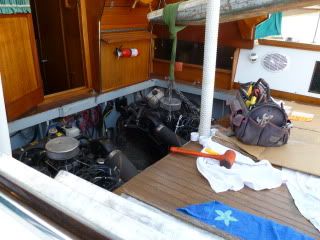

The bottom is painted and the engine is back in and undergoing final adjustments, might splash tomorrow!! It's been over 2 months and I'm ready to get her back in the water with the new engine.......not looking forward to writing the final check.... :( It's going to take some serious cleaning to get her back to her former glory after sitting exposed in the boat yard for over 2 months.....but nothing a little elbow grease and a few beers can't fix...Here's a couple pics for your viewing pleasure.......John
