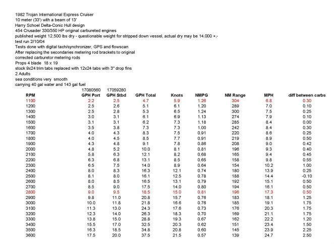

Here's some numbers:
Let's see if this transfers well...
Vessel 33' Trojan International, 13' beam, 12,500 lb dry,
Delta Conic Hull design, year 1983
Props: 4 blade 18x21 part# 0940 37171 and 37172
Prop Shaft is 1 1/4 diameter
Power - twin Crusader 454 cubic inch, 350 HP w/ Rochaster 4 bbl carbs
Velvet Drive transmission with 2:1 ratio
trim tabs 100% retracted
sea conditions - very smooth, winds variable
carrying 113 gallons of fuel in a 250 gallon tank
test conducted 7-15-02 in Charlotte Harbor
running gear 90% clean but not shiny
calculations done using digital tach/synchronizer, flowscan & GPS Difference from Summer 2002
Jul-02 Nov-03
kts nmpg kts nmpg nmpg increase
2700 15.0 0.67 15.5 0.82 22%
3000 17.1 0.53 17.2 0.70 32%
Here's the chart with NMPG data with the 454's

two options
1. run at displacement speed and "pick your moments" when to run at planing speeds, keeping her in the "sweet spot"
2. invest in a flowscan (not expewnsive if you have no return fuel lines) and dial in the correct RPM & tabs for the best efficiency.
Running RWS as in #2 above yielded me efficiencies of .8nmpg which equates to .81 NMPG at 2800 RPM at 15 knots - this is the equivalent of 17.1 MPH 18.5 GPH and that is the equivalent of .93 mpg (statute miles)
Not too shabby for a 33' vessel with a 13' beam !
Here is the raw data from when she was a gas burner.
This is an EXPRESS CRUISER - not a mid-cabin version of the species.
Keep in mind these are NOT fresh motors, they were on the low end of the compression scale and the port engine had a very, very sloppy timing chain.
Because the engines were tired, I chose NOT to wind them up too high for this final run.
These numbers are REAL, ACTUAL DATA.

Other changes made prior to that posted data include:
1 repairing the mechanical advance mechanisms in the distributors.
2. machining out the "diverters" in the cast iron exhaust tees (as reccomended by John Leed at Marine Tech (if I remember correctly)
3. messing with the pitch on the 4 blade props
4. disposing of the rediculous 1" tall spark arrestors and getting larger ones from Marine Tech/Beacon.
5. correcting the metering rod problems in the carbs which showed one engine using 5gph more than the other
we'll have to see what else I can think of !

Tom:
couple of ideas:
1. get a inexpensive inclinomoter at Wm or somewhere else.
2. get a full load of fuel and water and set the inclinometer up at zero when floating in the canal. Now yiou have a reference point to start from.
Think of it this way, if the bow is UP the props cannot do the kob they were intended to do efficiently, you need to get her ass out of the water. Could be a prop issue or a combination of manu items.
3. The mid cabin has different geometry than the express cruiser I have including different prop sizes and different final gear ratio. You should share info with the other mid cabin guys here on the website.
the floscanis a great sirst step, that way you can measure your results instead of guessing.
bottom, timing, advance issues, floscan, tabs, props, carbs, etc.
took me some time to get from .6nmpg to .8nmpg!
While these hulls will never see 1.0 nmpg you really do have lots of room for improvement.
These are great boats, the ride is that of a 40 footer and the beam makes foe tremendous usable space. Add in the solid design and engineering/construction and you have one helluva boat there.
Dial in the details and stay on top of the issues and your numbers will get much better.
PS - the drop fin tabs are simple bolt on replacements - contact Bennett
