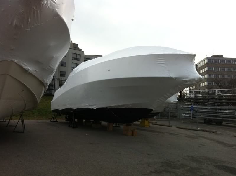

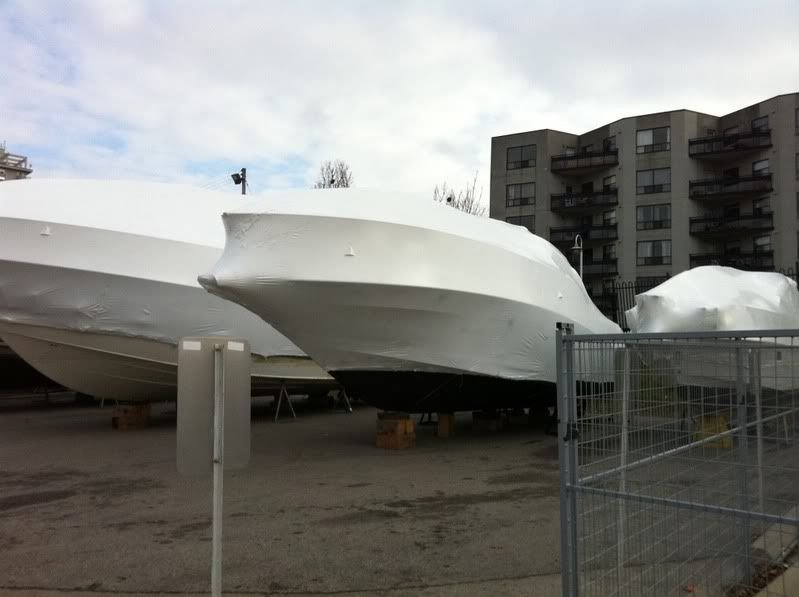

Here are 3 shots of good, tight wrapping. Two of them are of a 40+ Sea Ray Sundancer (I think - with a bigger Regal beside it) - so similar shape to your Express. The final shot shows how they dealt with a 38 ChrisCraft Commander (flybridge) and the Trojan 30 Fly in front of it. Tight is your friend, but make sure it has some ventilation, be careful of abrasion points (some people use those swimming noodles as spacers), and don't burn through it when shrinking!!

thanks again for the pic s captain m. i think mine looks close to those.hopefully can only get better at it
