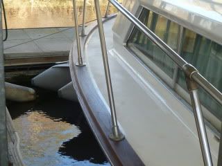

Here's the original Toe/Rub rail on my 1972 Sea Raider. I clean it annually with Powered tide laundry detergent with bleach, then oil it. Takes maybe 1 hr and 2-3 beers..............John
