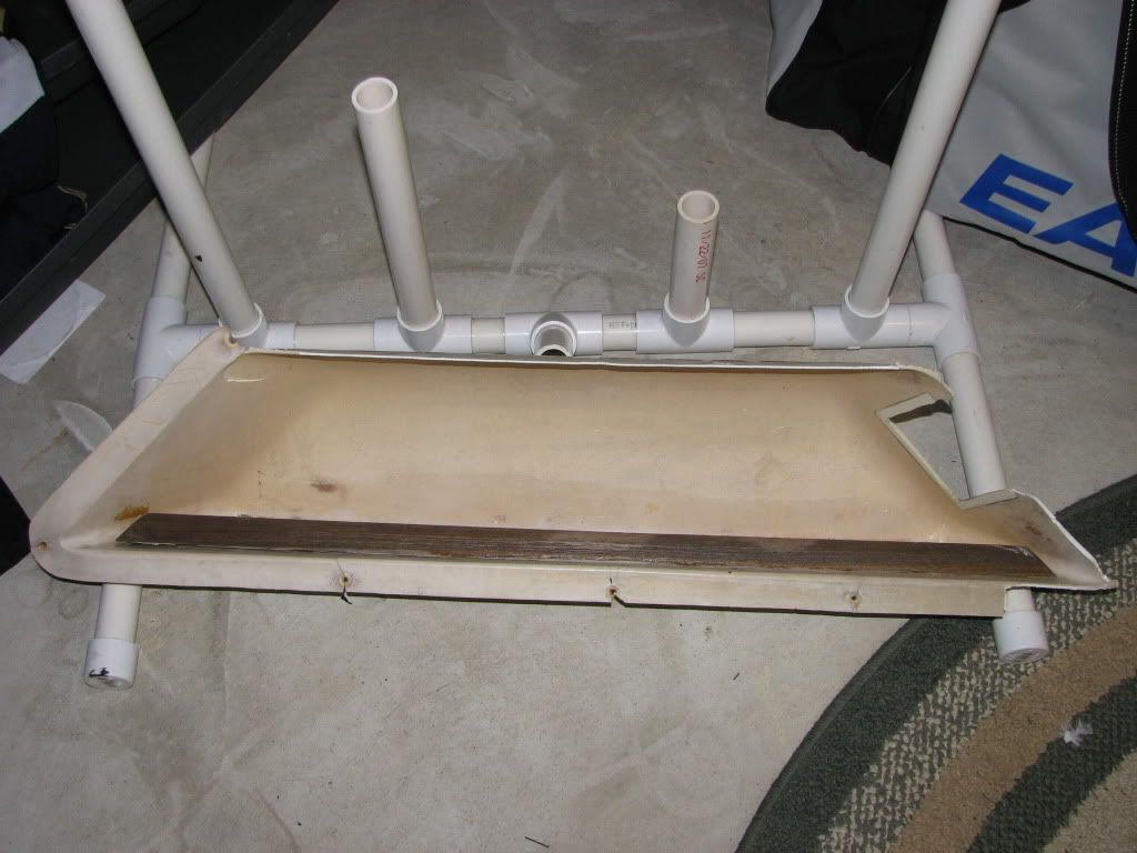

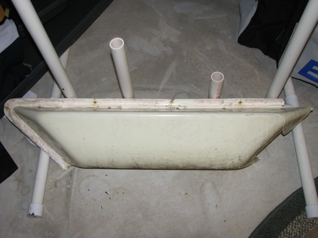

Here is a picture of the front coaming box that I removed. You can see the damage it incurred due to the sealant that was used. I wish they woudl have used 3M 4000 as that is removable.
I'm not sure if this could be repaired somehow or if anyone knows of a 10 meter that is being parted out. I did find a similar sized square one (34x9.5) from Great lakes skipper but I think it is designed to be mounted at an angle.
