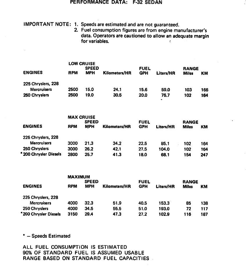

Posts: 12723
Sounds great but .I think you will find the fuel burn a lot higher at speed . 20-25 gal plus a hour at cruse ( total for both engines ) . 4-5 gal per hour ( total both engines ) well below hull speed maybe .
Other F32 owners whats you fuel Burn ??
