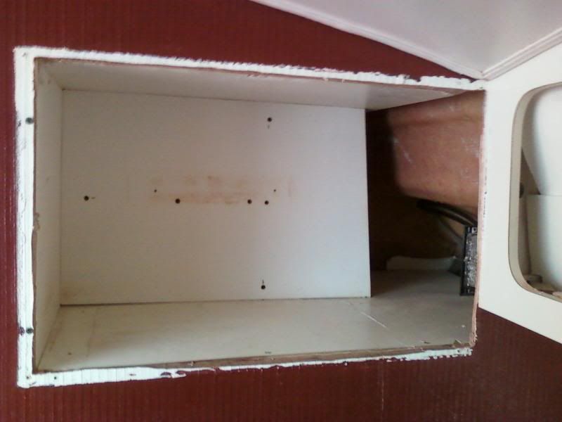

Any suggestions of one that "fits" the cutout on a mid-cabin?
Brands with model # and a picture of the refit would be appreciated.

Weird coincidence.... Just removed mine Friday for the same reason. I've researched a bunch of models already, the depth on the original one is unusually shallow compared to what they make today. You really need a .07 CU foot model, .09 is close. I don't mind going a lot smaller because I find the big door annoying swinging from the right (which they all do). Even a .07 will fit a dinner plate which is the biggest thing we use it for.
I bought a .09 already but didn't notice the bump out on the back which made it stick out about 2" too far. I'm calling Amana tomorrow to verify the measurements on another model. If ok, I'll post the model. I briefly looked into the combination units but they don't get great reviews.

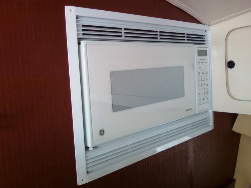

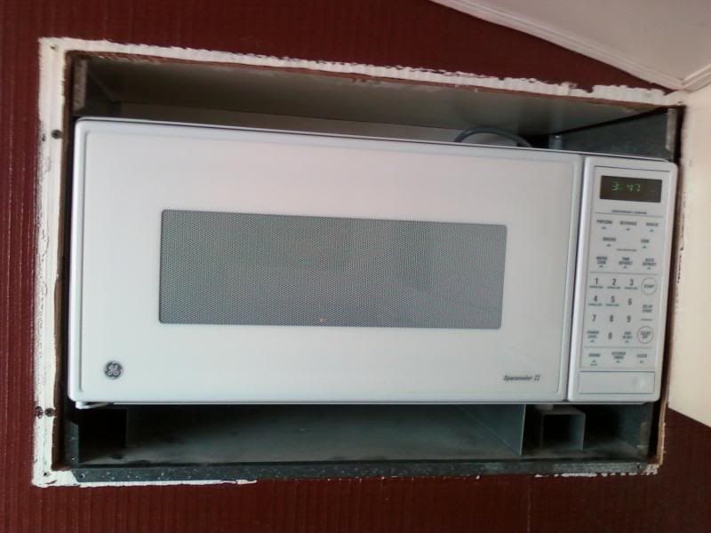

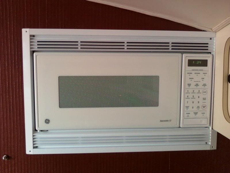

Craigslist saves the day again! Found a GE Spacemaker II with the mounting kit for $50!
The is the ONE that fits the cutout. I did have to trim the hole right to the edges but it fits perfect. The trim kit needed to be cut on one side to go around the cabinet but covers the area that the factory trim did and looks much better!
Here's the pics in case any one else goes the same route.The pics are cut off for some reason, you can click on them to see the full pic in photobucket.
