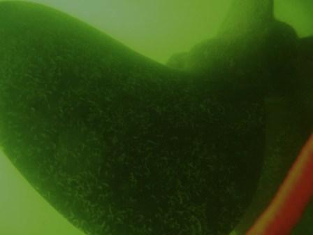

Here is what my props looked like:
There were a couple barnacles as well. Rudders and bottom looked similar.
