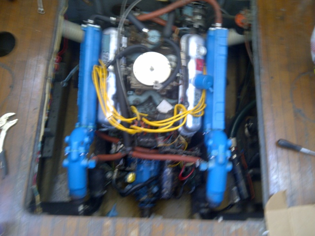

Glad you making progress . Mine is 318 but similar issues .. and finally put it together.. Over next week will put rest of it together and hopefully fire t up next weekend . Don't give up as there is light at end of tunneltoday was a good day. also the rest of the gaskets I needed came today.

thanks-you were right,I did get it.
What a pain.the third bolt towards the top of the manifold must go in the manifold before trying to get the darn thing on.I had the first for bolts on from the bottom end one time and had to take the whole thing off because there is no room to get the bolt in on my boat because of the sidewall and the angle of the manifold.
Still confused about the water inlet elbows.-manual update says the water should enter the manifold from the bottom end (lower) of the manifold and the top front should b e plugged to eliminate manifold cracks from steam?
