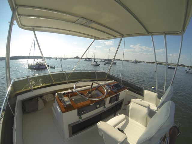

I am looking to set up my F32 with some new electronics and would like ideas on the layout. I will be starting slow by adding a chart plotter which will become a backup as I eventually add a plotter / sonar combo.
Also what would you recommend as an entry level chart plotter?

Looks nice Mel .
Re: Lets see your helms
Mel,
I love that, having it in the center is nice. I do not have room there with my gauges and I am not sure I would move the compass to put it on top. I am thinking I will end up with it on the stbd side of the helm where the old one is now but not really a fan of that location.

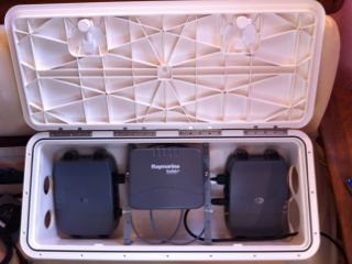

Spent the winter on this project, 1976 F32. The upper helm was just full of holes from many years of different electronics and other things taken on and off, so I decided to redo the whole helm. Especially since I wanted to upgrade all the electronics. I spent hours on different layouts in my basement before settling on this, still got one or two things wrong, oh well.
A couple of other ideas I had was using a pod for the C90W at the upper helm but this did not work out as it completely blocked any view the passenger had. So I decided to flush mount it, not happy with this as I have to lean over to see it, so i'm making a angle wood thing so I can view it better. I mounted all the Raymarine Pods in a watertight locker under the front bench seat, then tried to get the 3' of separation by putting the VHF pod under the helm at the opposite end.
The C140W is at the lower helm on a rolling track that runs the from port to starboard so I can roll it all the way to port where it's out of the way then roll it to starboard or mid ship over the stairs when i'm at the lower helm our out on deck fishing. It's a BIG unit and viewing the fish finder from the cockpit is great.

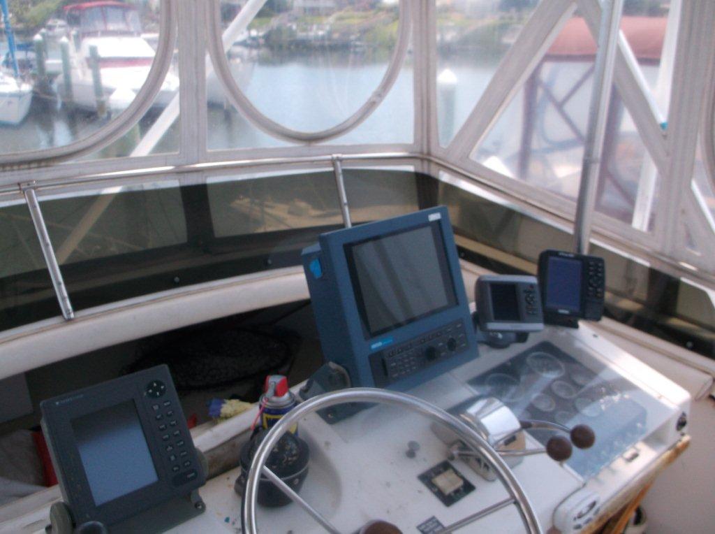

My helm from Left To right Furuno color fish finder , Koden radar ( muti function) Garmin 441 gps and Garmin 182C . I could Use the Koden and see radar , gps and f/f at once But I prefer to use it for radar only and use a split radar screen .one screen close and one far .
I also have 2 VHFs in the overhead box .
Anyone want to guess whats on the lower helm ?
