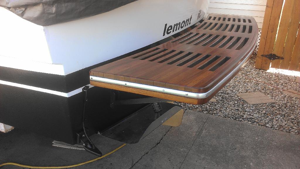

Sweet. Is the transducer a new install this winter or has it been there for a while? A little worried that it's so close to the outside edge and whether the water rushing by the side of the hull would hit it on plane. That would be a lot of stress on the unit.

The transducer is new, I did take a peek over when i opened her up. i thought the tab wash would cause problems seemed ok. No rooster tail,
