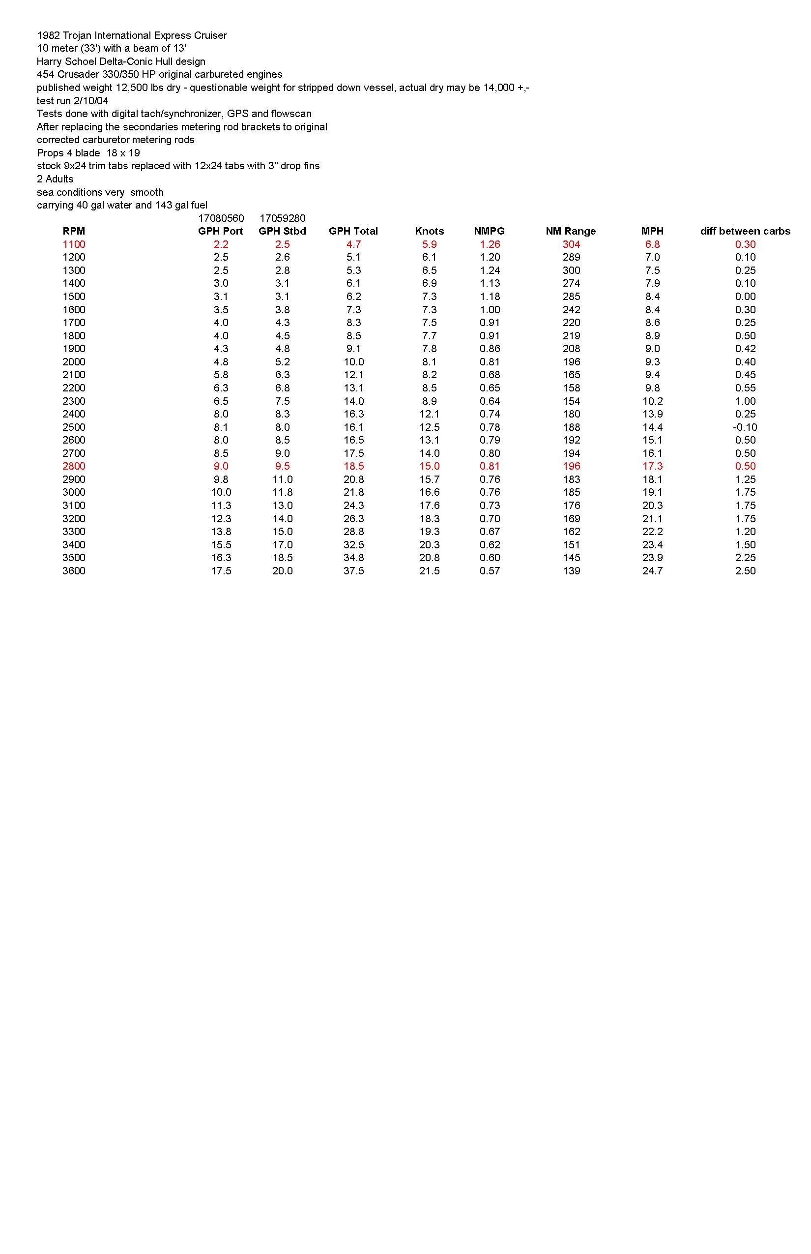

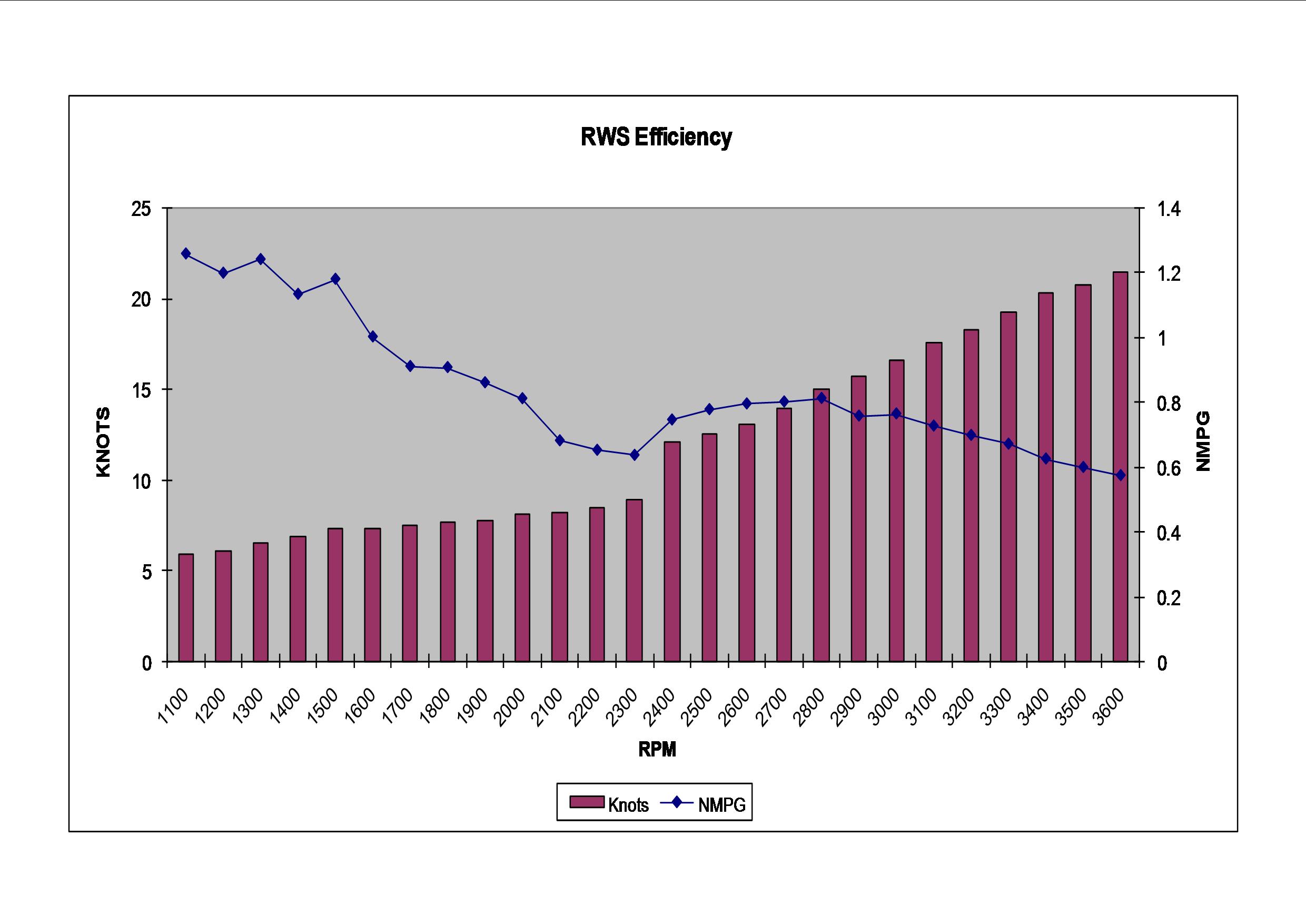

here are the numbers from my 1983 Trojan International express cruiser before the refit.
one is the data, the other is a fuel/speed chart
you will have to click on each one, I don't know how to make them smaller
data collected with digital tach synchs, floscan & GPS.
swinging 4 blade props
- RWS_GAS_CHART.jpg (222.04 KiB) Viewed 5991 times
- RWS_GAS_ACTUAL_DATA_DETAIL.jpg (246.32 KiB) Viewed 5991 times

You would do better on fuel at 7 knots 8-9 is above hull speed . A lot of folks will cruse at 3000-3200 rpm , but youll burn a lot more fuel then going slow .

You're numbers will probably a little worse than RWS's as you are heavier and have more sail area. 7-8 knots is my new "cruise" speed. Saves a lot on gas. I pick it up when it gets rough or I need to get back sooner. Otherwise, I plan for a longer trip. My boat great at higher speeds, actually faster than cruise for the 454. Fuel burn is crazy though.
