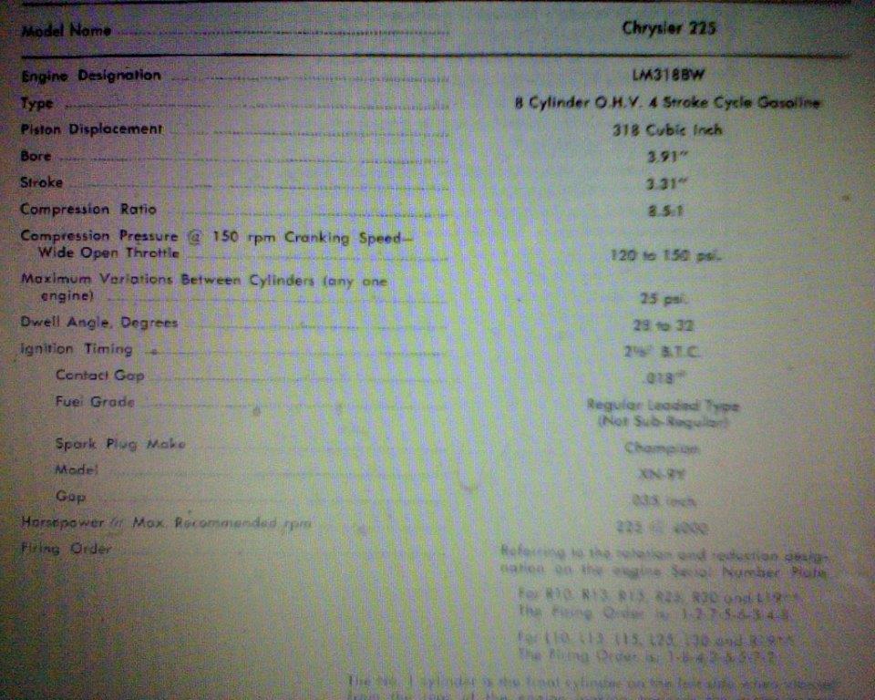

Re: Whats everyone using for spark plugs
Checked and I put wrong manual up..... here is the LM page which confirms your XN9Y... I have edited this post accordingly to remove any chance for confusion as time goes forward.prowlersfish wrote:I come up with XN9Y Champion . They have a longer reach then the J plugs . I know the big block ( 440 etc) us the J reach plugs . LOOK at the threads in the head you should be able to tell
Ready Can you recheck your info ? Mine can from a Chrysler marine manual ( online here) and my memory ( for what that's worth )
Here is a copy of page from manual......
I see your info is for the M318 ( old stlye ) My info is for LM318 , Different heads I believe the they switched to LM in the early 70s or late 60s look at the HP , . Most LM318s are 225 hp and would take the N plugsready123 wrote:Here is a copy of page from manual......prowlersfish wrote:I come up with XN9Y Champion . They have a longer reach then the J plugs . I know the big block ( 440 etc) us the J reach plugs . LOOK at the threads in the head you should be able to tell
You are correct I posted the old manual, which still might suit the OP if his engines are that old.prowlersfish wrote:I see your info is for the M318 ( old stlye ) My info is for LM318 , Different heads I believe the they switched to LM in the early 70s or late 60s look at the HP , . Most LM318s are 225 hp and would take the N plugsready123 wrote:Here is a copy of page from manual......prowlersfish wrote:I come up with XN9Y Champion . They have a longer reach then the J plugs . I know the big block ( 440 etc) us the J reach plugs . LOOK at the threads in the head you should be able to tell
OP what is your HP ? or can you post a photo of you engines I can tell you if you have a M or LM
I have changed my post to show the new manual for LM engines.
