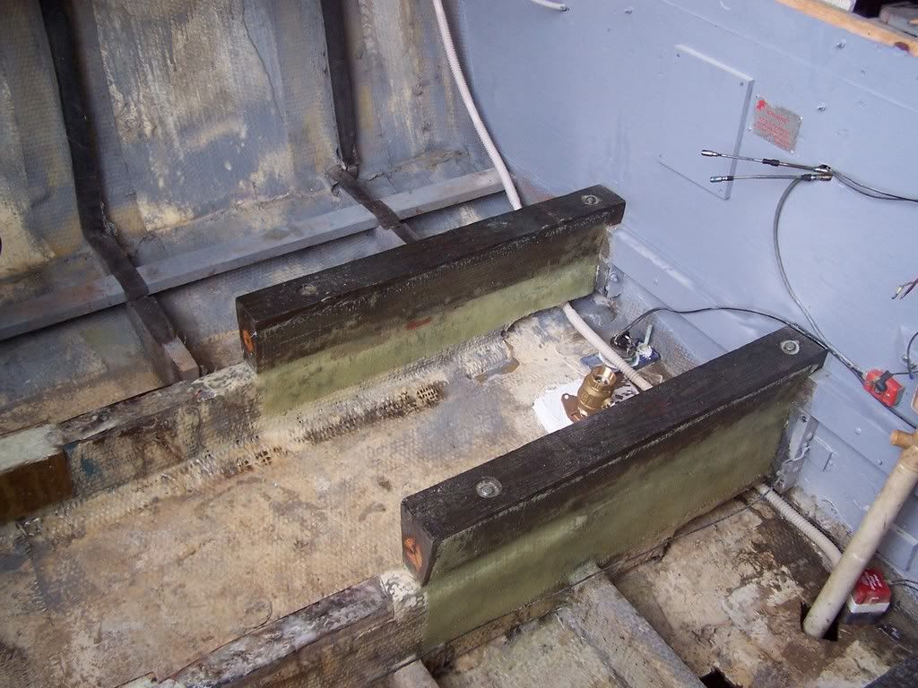

Mine leaked from day one due to not enough resin to fill the mat over the keel in certain areas (pin holes). I drilled, punped it out then cut the hole bigger to put the pickup hose fitting into the hollow keel.
I posted this pic in another thread,
http://www.trojanboats.net/wforum/viewt ... ollow+keel
