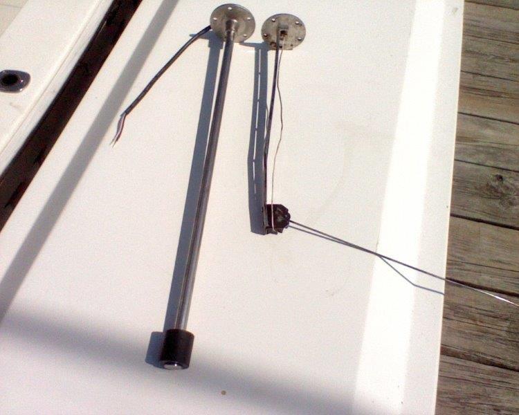

Re: Help with Fuel Guages
Wema to the left junk
(swing arm ) to the right .

I replaced all senders (5). Two fuel, fresh water, black water and gray water. They work great... Great quality.

How do you figure the length on those? Just measure the tank and get the one that best fits?
Also, how do they wire up? Mine only has one lead. I am figuring that the negative side gets it form the tank.
Ok, so I think I answered most of my own questions... I'll have to take some measurements on my next trip down there. Maybe I'll buy one of these and give it a try.bjanakos wrote:How do you figure the length on those? Just measure the tank and get the one that best fits?
For what it's worth, there are some 5" holes drilled in the floor above the forward fuel senders, so perhaps this has been done before.

Measure the tank depth and use 1" shorter unit . 2 wires one to ground and one to the gague . The Wema diagram shows pink to ground black to gague but it will work both ways .bjanakos wrote:How do you figure the length on those? Just measure the tank and get the one that best fits?
