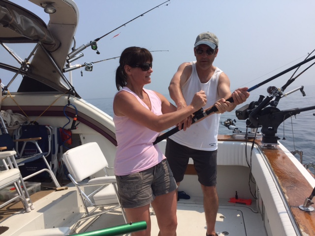

Couple quick photos of the pleated vinyl I went with instead of the original three separate cushion style. The original three cushion style can be seen a little further up the boat. I originally redid the vinyl in plain white keeping the three cushion original style. Like I previously said, the kids would get there toes in there and everything else while climbing in and out. I finally went to one piece, using pleated. I only used 1/4 foam, whereas the original was very thick. I also implemented some grommet holes across the bottom under the combing to act as drains and it worked magnificently.

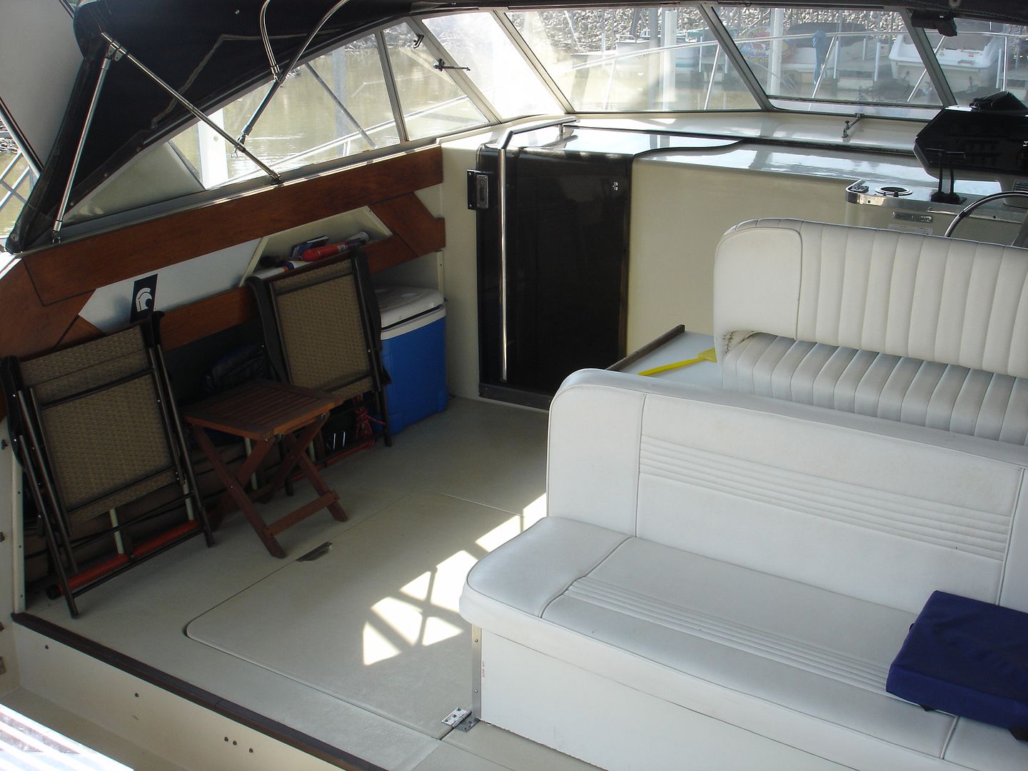

It's not the best picture of my Combing Boards, however they are finished wood the same as the boards on top. This was an option and the boat came this way. Do not have to worry about vinyl getting messed up.

Thanks Dave - that style looks great. I appreciate all the tips!

Any other pictures Flyboy? I love the idea of teak in that area. Also, that back seat looks great. Was that custom? I don't think I've seen that on any other boat..

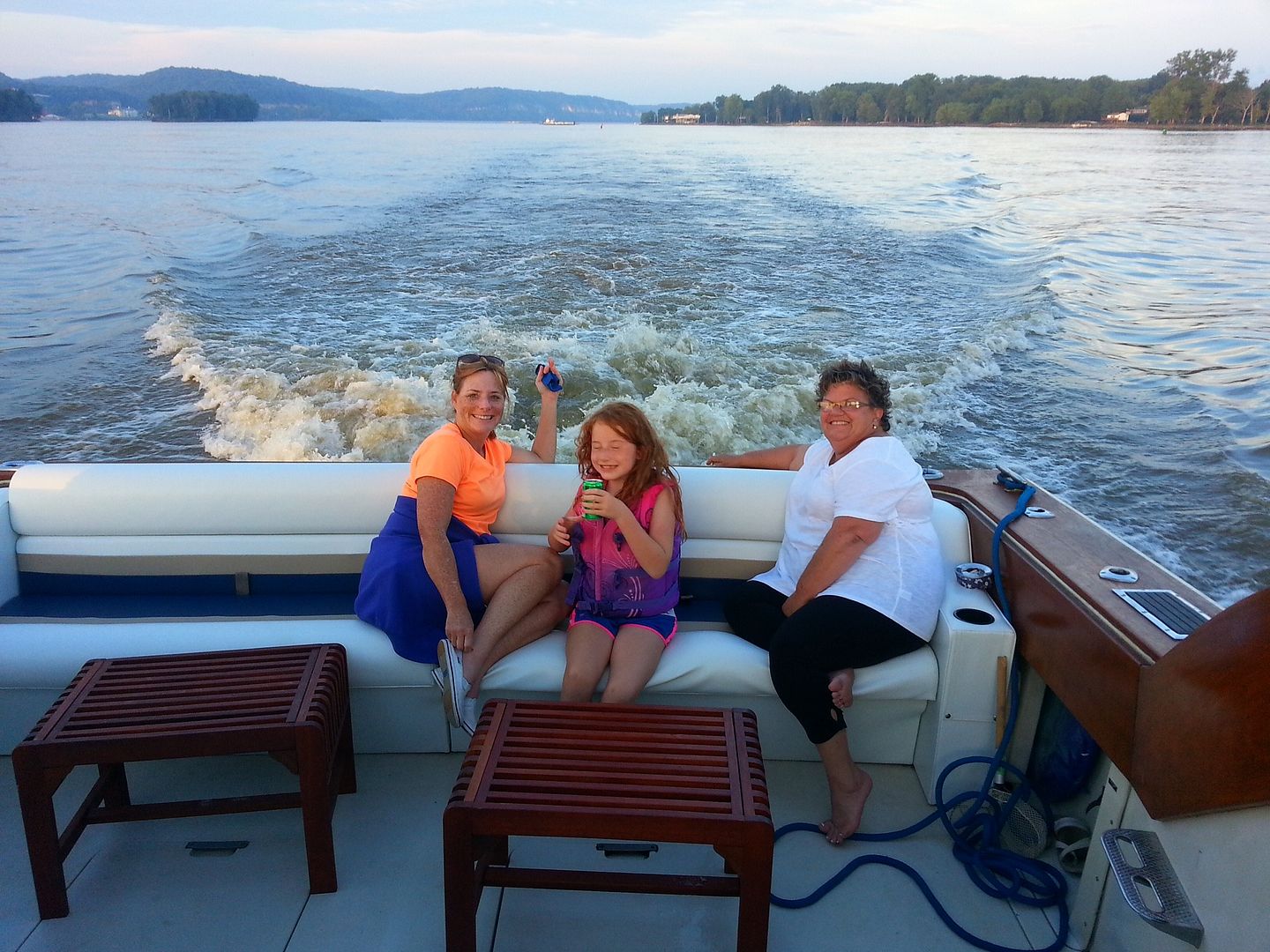

These are the best pictures I can come up with right now. The seats came from Veada (veada.com). They have other styles, however I used the 55" CL05 seats and the 7" W106 armrests. That combination fits perfect between the combing boards. FYI, their measurements are a little off on the Armrests, the 7" is actually 8" and the 8" is actually 9". We are very satisfied with the quality of their products, it is an Amish company.

Thank you for sharing and for the seat information. I like the look of the that teak and have never seen it in place of combing boards. Nice boat!
