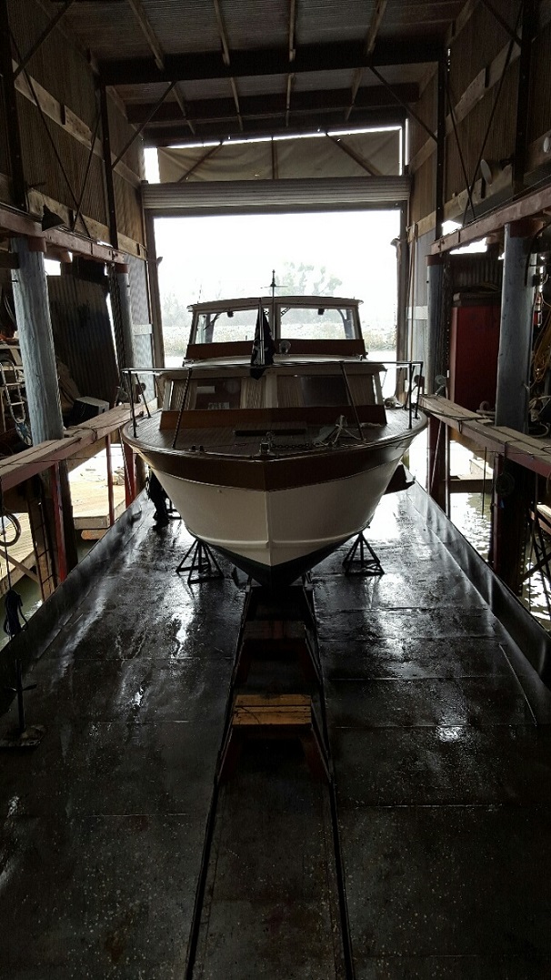

Don Shanks
Re: 1965 28 Sea Breeze New Life
My wife came up with the name
- trojan14.jpg (176.54 KiB) Viewed 11175 times
- trojan12.jpg (247.6 KiB) Viewed 11175 times

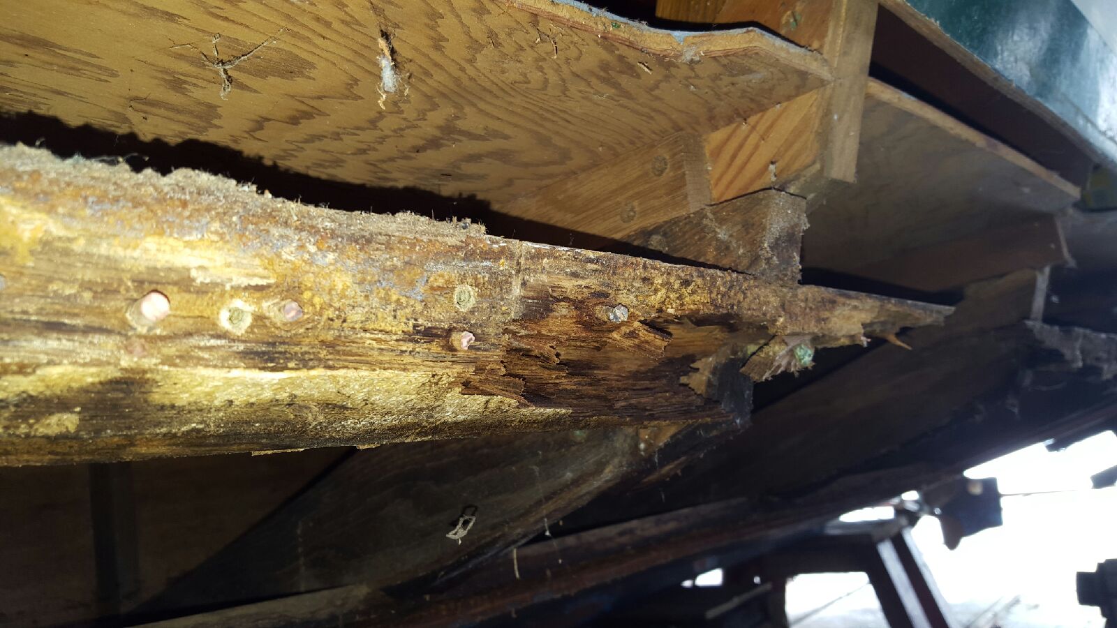

Don,
Love the fact that you want to fix what needs to be fixed.
The chine rots out on these Trojans and also on Shepherds because the chine itself wasn't angled properly to allow the water to continue unimpeded into the bilge. The water simply lays on the top surface of the chine. (I'm probably not telling you anything you don't already know). I have done chines in several wooden boats for this reason (especially Shepherds with roll down windows).
The rot spreads outward from the chine. The fact though, that the chines are showing wood rot doesn't mean the rest of the boat will necessarily be in the same state because the 90 degree chine was a design flaw. I will say this though, that when I had rotted chines I sometimes also had a rotted bow king board.
The above views are only from my own experiences and others here may have different thoughts to offer.
The twenty hours predicted by Ramon may end up being forty hours imho........ but still very well worth doing.
Possibly consider discussing with Ramon, the idea of angling the chine repairs to allow for freeboard water to drain unimpeded into the bilge.

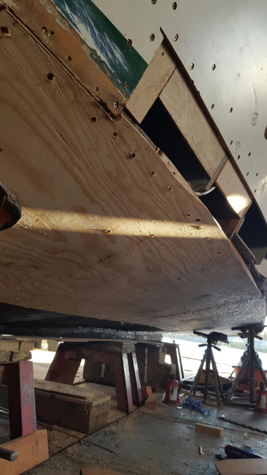

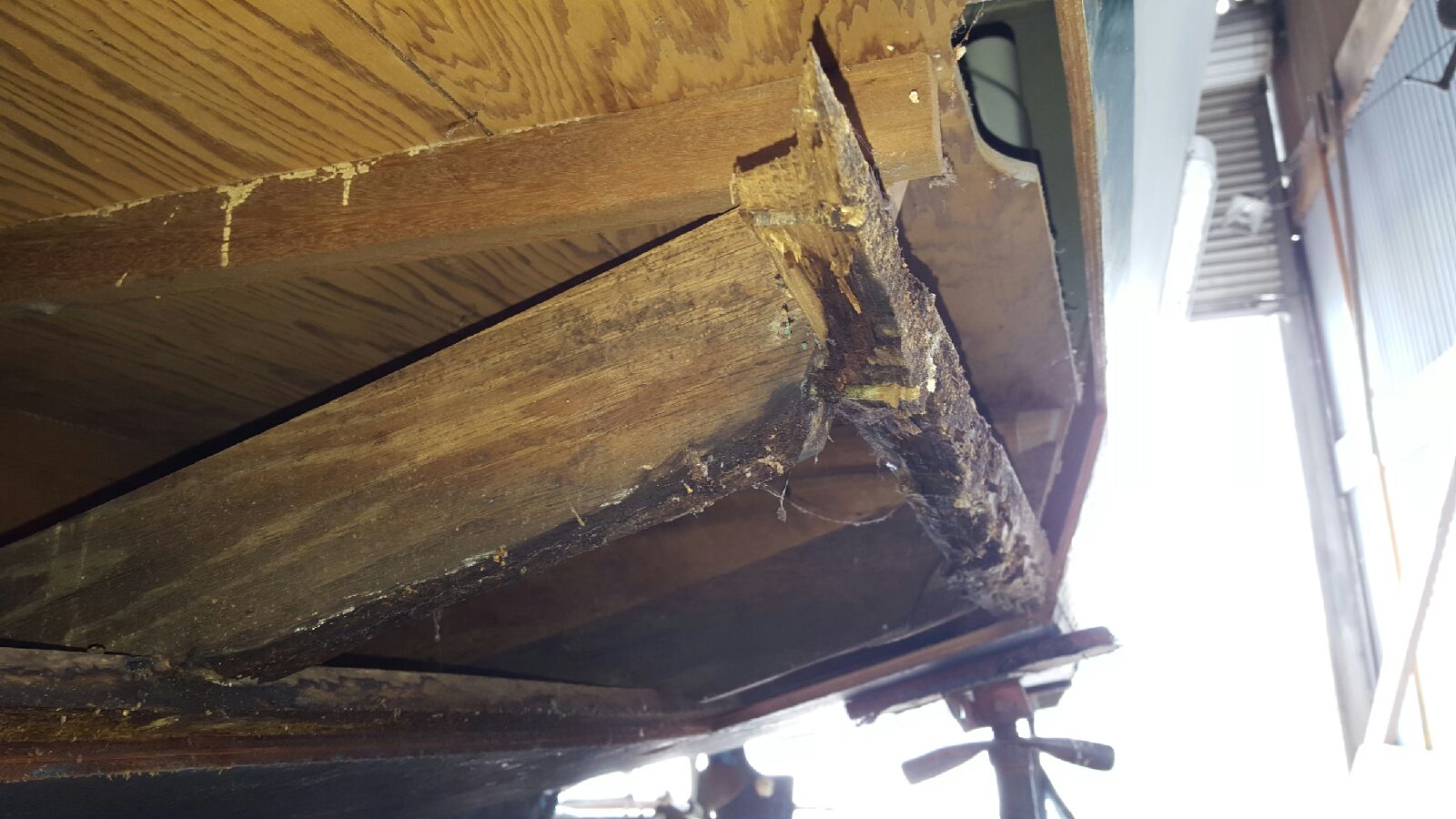

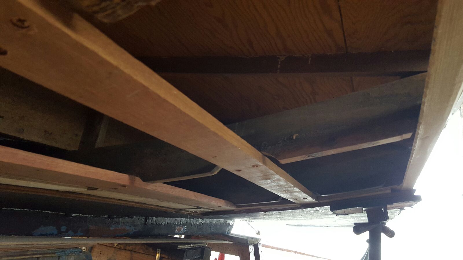

A few progress pics. You're right Rick, more like 40 hours. Had to find the end of the soft stuff
- 20160126_122630.jpg (139.02 KiB) Viewed 11058 times
- 20160125_162801.jpg (183.92 KiB) Viewed 11058 times
- 20160122_132141.jpg (135.74 KiB) Viewed 11058 times

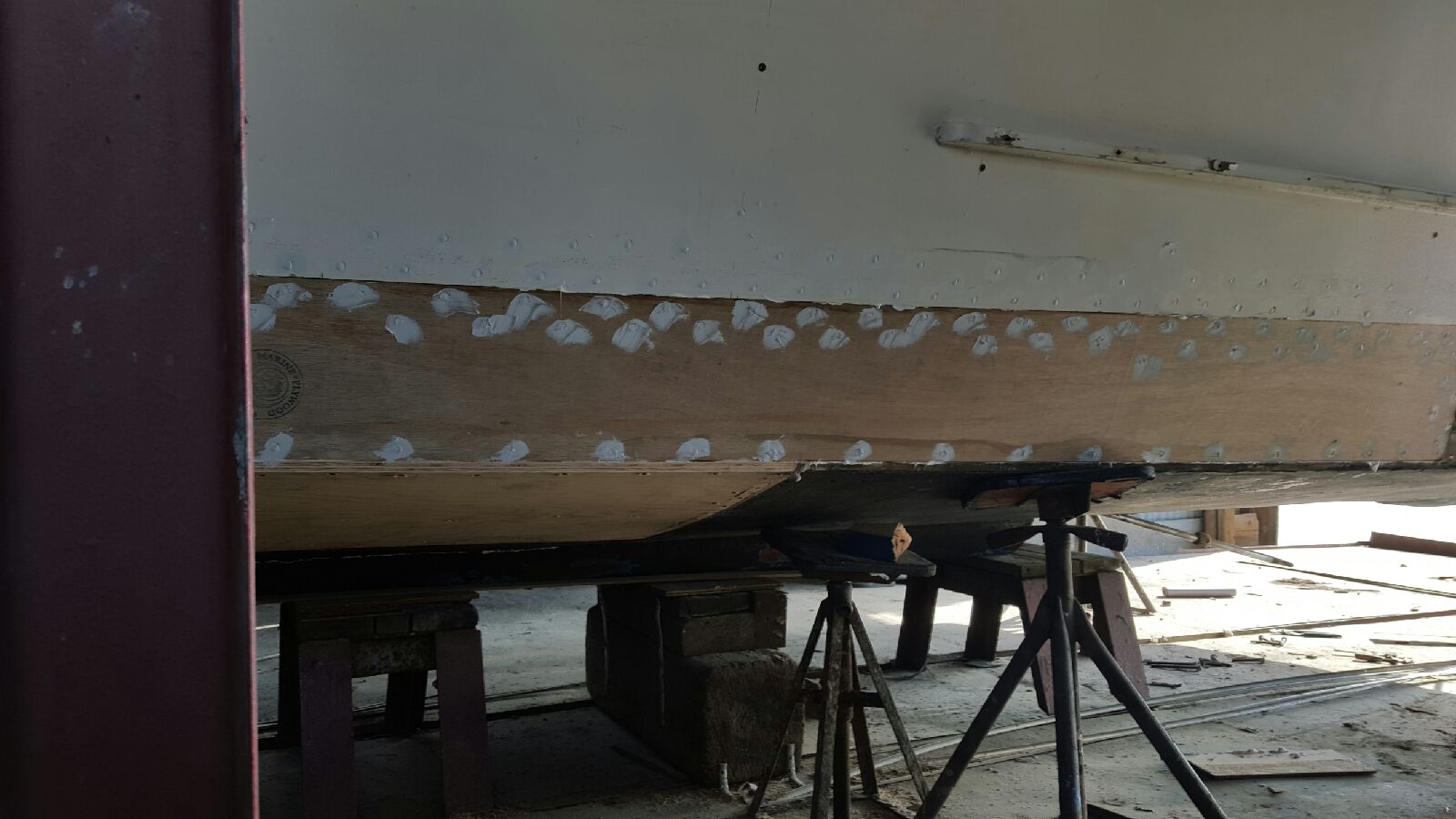

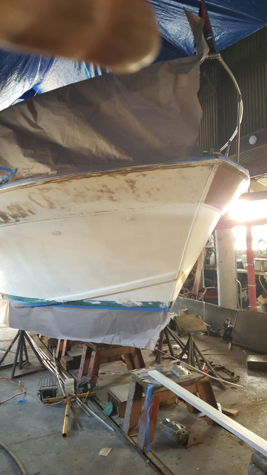

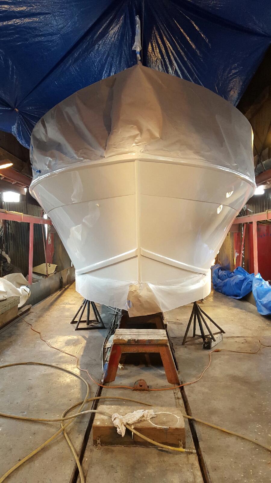

Getting closer. Two of these were today 1/27
- 20160127_160402.jpg (167.48 KiB) Viewed 11058 times
- 20160127_160354.jpg (168.69 KiB) Viewed 11058 times
- 20160125_162658.jpg (142.9 KiB) Viewed 11058 times

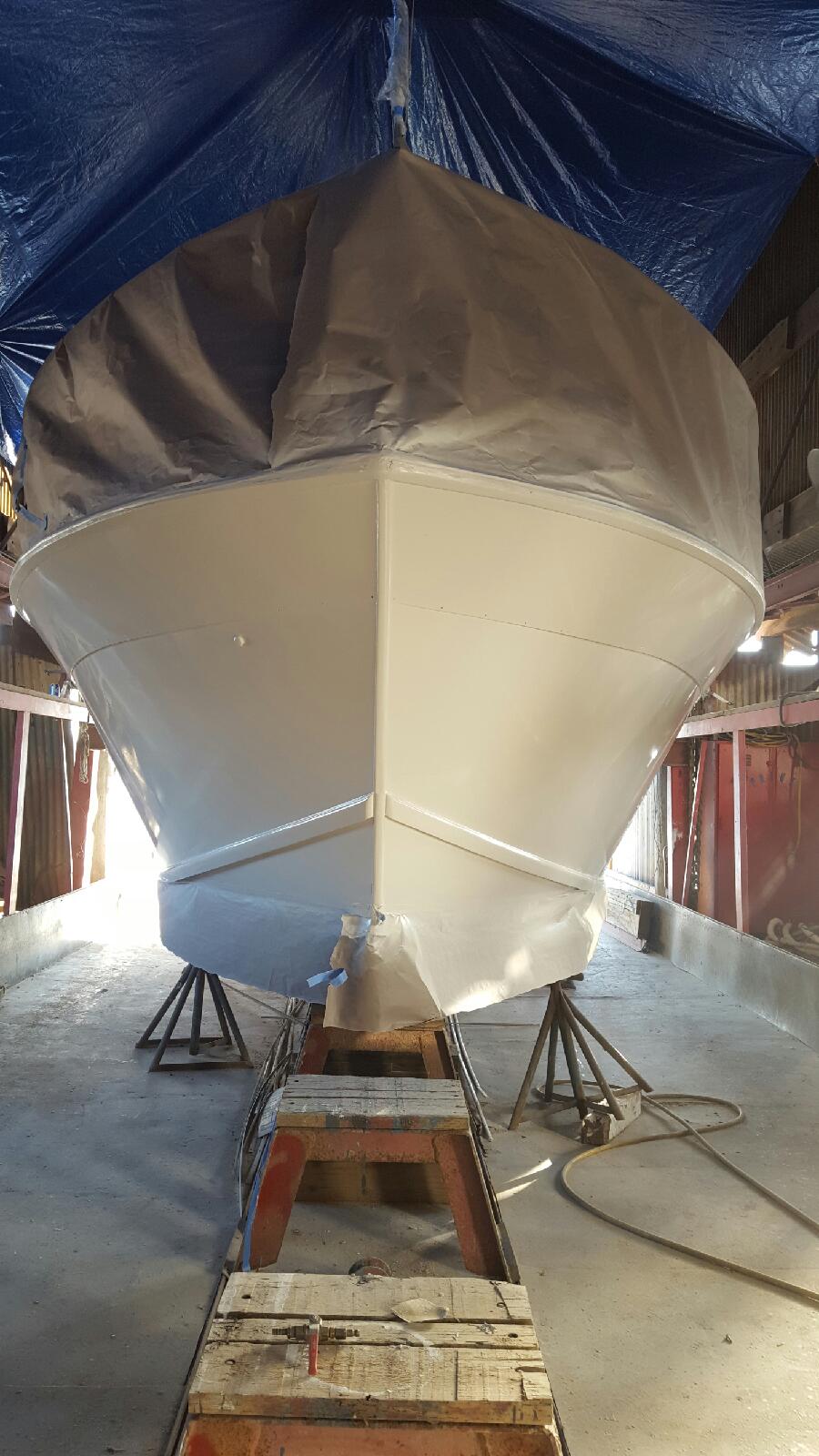

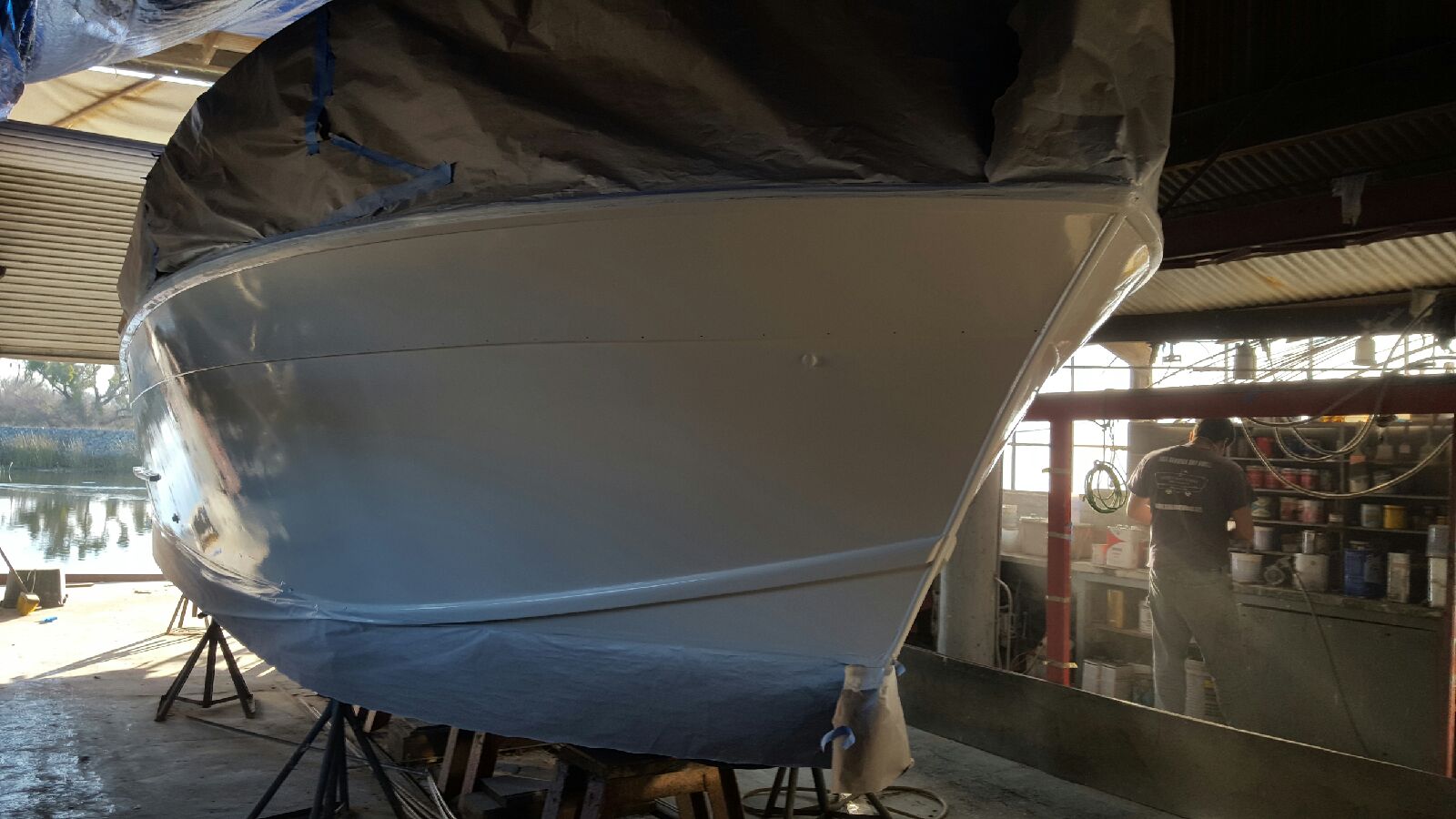

2nd coat of paint. Splash next Wednesday
- 20160129_141320.jpg (183.65 KiB) Viewed 11041 times
