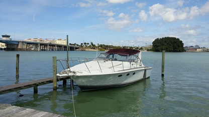

Greetings, recently purchased a 1984 Trojan international 10m express. She is now dry docked so we can work on her.
The plan: basically, bought this to be a live aboard for my fiance and me, staying at our local marina. Structurally, she is sound. Mechanically, she needs just about everthing.
Purist, please forgive us, but we are considering turning her into a strictly live aboard boat. Pulling engines and related hardware out and creating a living space in this area. Anyone ever done this? Is it difficult to remove engines? Are they worth anything whole? As parts? There seems to be 3 or 4 fiberglass structural beams about 8" high on each side of engines, we wanted to knock those down also. If she is only used to float, removing these should not be an issue correct?
Any ideas, help, appreciated.
