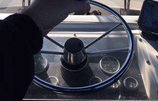

Hi, new user, first time Post here. I purchased a beautiful F32 last season, and had a great year with it! This year, i am looking to upgrade my Gauges on the Bridge, i had some inconsistant reads on my Temp and Oil Pressure gauges last year. Looking for any input on what type of gauges to look for, preferably modern style.Any input would be appreciated. Thank You.

Welcome aboard. Sky's the limit really in terms of which gauges to go with. Just make sure they match the impedance of the senders currently on the engines or they won't work right. Keep in mind that anything between the sender and gauge could also be the reason for poor readings. The wiring, connections, plugs, corrosion, etc. can all be culprits and will still affect readings on new gauges if that's where the fault lies.

Not sure if they are, but those look like Delco guages, and keep in mind if you replace with modern gauges, you will need to replace the senders also.
I had Delco on my 77 F-26 and learned that lesson when my temp sender went out. Bought the M/C replacement sender and it would not work with the Delco guage. Bob at Beacon helped me through that one.

So, i haven't checked back on this thread for a while. I ended up getting a full set of Teleflex International Gauges. I installed 1 gauge, (took me about 2 hours). The combination of the lack of spare wiring, and having to change our the Butt connectors, made for a painful project. Debating getting a professional to finish the job. Need to make sure all Gauges are accurate! Thanks for the input!
