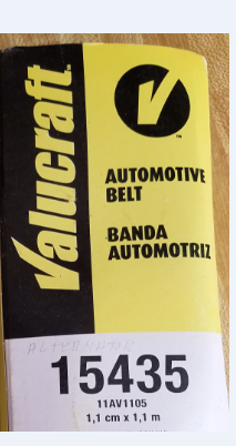

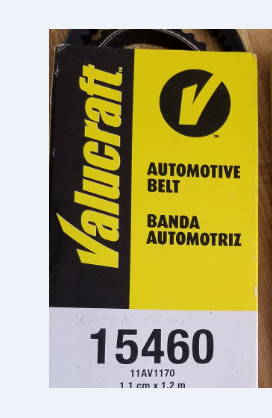

wolfe99
Posts: 10
Joined: Sun Jun 19, 2016 12:11 pm
Re: 1979 F25 318 Belt change?
Post by wolfe99 »
These are the belts I have, they came with the boat when I bought it. If these are right hope it helps people with ordering.
larryeddington
Posts: 1876
Post by larryeddington »
I will check my belt holders, length may be different as there are different ways of mounting the alternator. But just look at them and see if they set all the way into the v of the pulleys. I have noticed a lot are too wide and do not set all the way into the V. If belt is outside the pully notch it is just wasted and may not track correctly. May work but not correct.
In a little bit will go over to shop and check. If you go to a good parts store the number on the belt will give both width and length.

my raw water 318 pumps use a 7465 or a 15465 depending on brands. The belt is 3/8 inch wide and fits perfect into the pulleys. Now my alternator belt is a 15410 which is a 1/16th wider at 7/16 inch wide.
