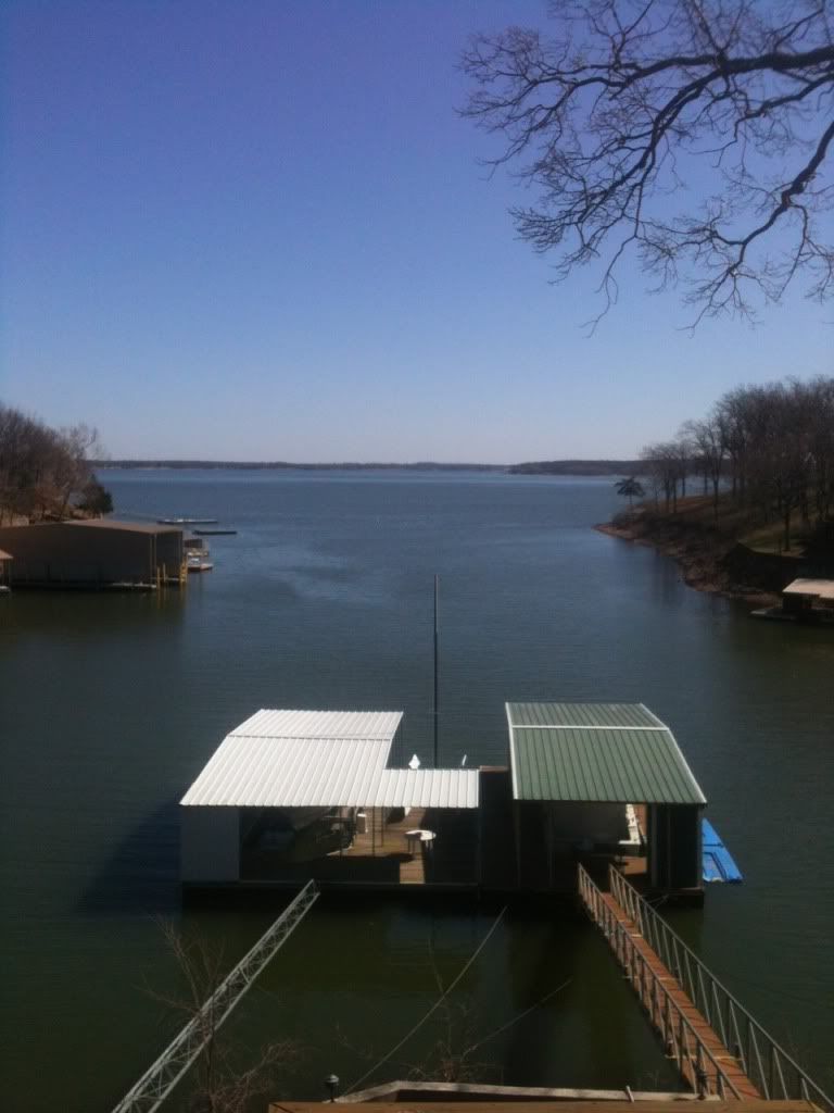

Also have our new dock in place. It's been a big week!

Hey Joe welcome! Very neat, love the boat house! Could spend the rest of my life down there

I am loving the new dock! There is a 42' slip on each side with a sundeck in the middle for the Hobie Cat. Most of my nights are spent on the boat... even though I have a really nice bed just up the steps at the house.
RWS -
