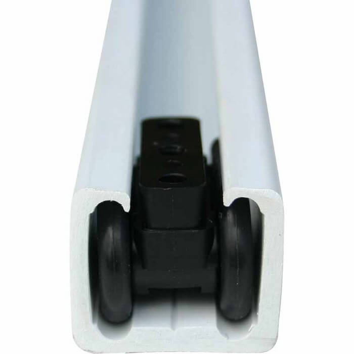

On my 12m, the tracks were a mess. I almost considered dumping the sliding door and going with a more modern sport fishing style hinged door, but it was cost prohibitive. I instead replaced the bottom of the door with a captured poly wheel setup from Boat Outfitters, and then screwed poly track down to the sill. The poly spacer block between the wheels and door edge adjusted the height. Works great.

El L Sea, I am not sure about the orientation of your photos. Are the wheels vertical or horizontal when installed?
Re: F36 Convertible Sliding Door Track
The wheels screw into the bottom of the door, and the tracks screws where the old track was. So I guess you could say the orientation is the wheels roll along the deck. The picture of the door frame (1st pic) is from the side on my workbench. I actually just slid the bottom part of the door off the glass and everything so I didn't have to haul the whole door home. The bottom picture shows the actual orientation.WayWeGo wrote:El L Sea, I am not sure about the orientation of your photos. Are the wheels vertical or horizontal when installed?

The photo without the glass threw me off -- now I understand. How did you remove the existing track, or did you put the new track on top of it?El L Sea wrote:The picture of the door frame (1st pic) is from the side on my workbench. I actually just slid the bottom part of the door off the glass and everything so I didn't have to haul the whole door home. The bottom picture shows the actual orientation.
