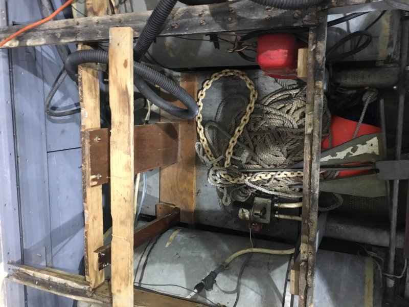

Looks amazing. Shrink wrapping the boat this weekend and ill be starting the demo work this week. 1 question for you. Your keeping the original tanks?
1974 f32 Sedan
Twin 233 Mercruisers
BradZ
Posts: 161
Re: Refitting a 1976 F-32 Journal
Post by BradZ »
I've been over every inch of these tanks and they look and feel solid so for now I'm sticking with them. I am making the hatch bigger so the tanks can come out when needed. But with that said I have a fabrication shop pricing new aluminum tanks. But from what I have read aluminum tanks can go bad pretty fast. Why do you ask?

I am redoing my deck and i am replacing my tanks. But they are dry right now.. i want to make my hatch larger as well. Do you habe any sketches on how your going to make the hatch?
1974 f32 Sedan
BradZ
Posts: 161
Post by BradZ »

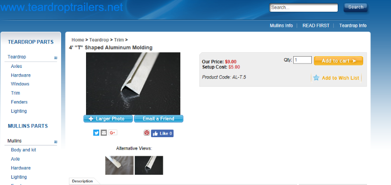

No sketches Captrichc, I work things out in my head mostly. Basically I'm extending the existing hatch opening towards the sliding doors. the tanks measure 48" long so I'm going to make the opening about 50". I haven't remembered to measure the height clearance yet because I keep forgetting to when I'm at the boat. But there should be enough clearance to roll the tanks over the inboard stringer without hitting the underside of the deck framing. I was looking for the same aluminum trim so I could extend it for the new hatch but so far no luck. I have found some 3/4" aluminum teardrop t-molding that will work just fine to. I will have to frame the hatch opening like the engine hatches so the molding doesn't need to be structural.

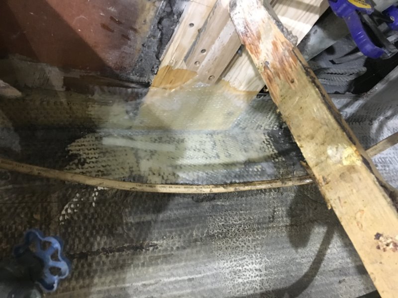

Just finished the fiberglass tabbing on the new bulkhead. Used two layers of 24 oz woven roven for each tab. I cut the second layer so the fibers were running at a 45 degree angle to the first layer. The first layer the fibers run horizontal and vertical. Of coarse sanded the existing fiberglass and using epoxy resin. Tabs on the cockpit side and on the engine side. Should be stronger than factory. Next cut out the rot above the bulkhead on each side and add new plywood.

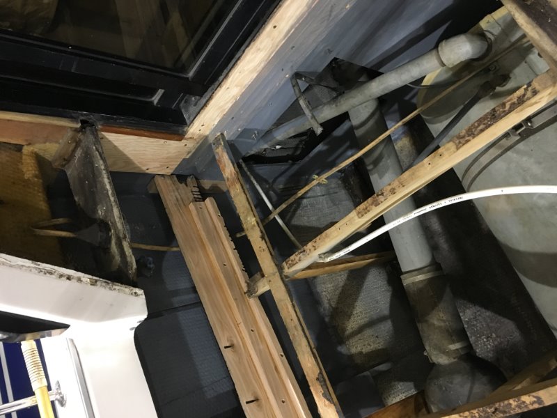

Looks awesome. I found a new issue with my sliding doors. I have almost a 1 inch gap between my sliding door frame and the gunnel wall on the port side. Seems like the screws pulled. And the wall bowed a little. I will post pictures this week.

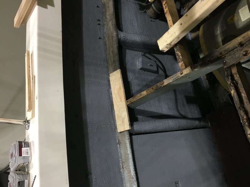

Finally all the work on the bulkhead is done. And if you don't now what it looked like from the factory you would be hard pressed to find the new work... Fresh coat of paint on all and now I can finish the deck and cover it all up...

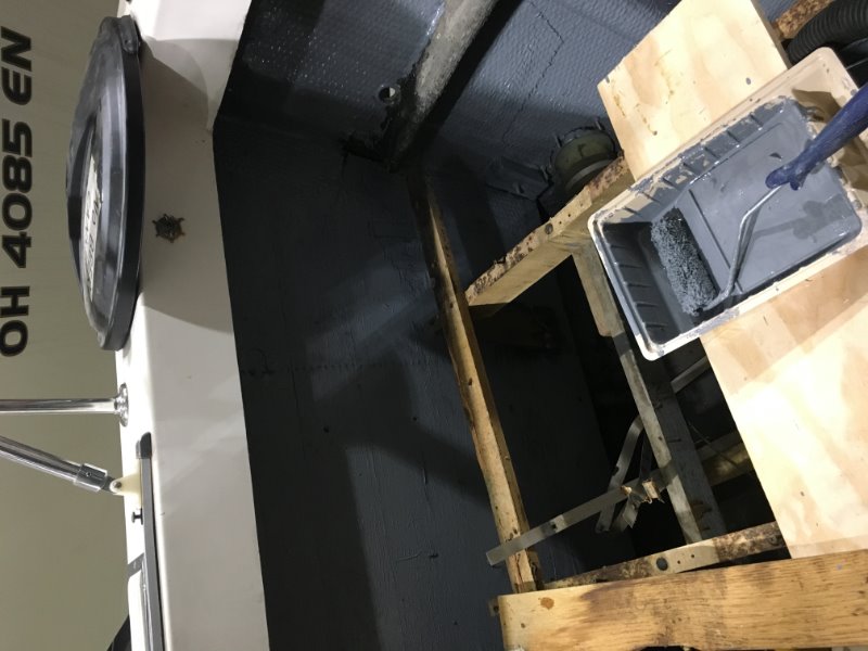

Plain old Rustoleum high gloss enamel (smoke gray). I painted all the vertical surfaces with out adding hardner. But when I do the bilge floor I will add hardner. I want to wash down the floor of the bilge and degrease it before I paint it. I can't do that till the boat is moved outside of the storage building. Using an enamel paint gives the best adhesion and coverage on both fiberglass and wood. What you see is one coat of paint. The wood parts soak it up but all I'm looking for is a good protective coating. Trojan only painted the bulkheads but not he framing or underside of the flooring and it lasted 42 years so I think mine will last at least that long.

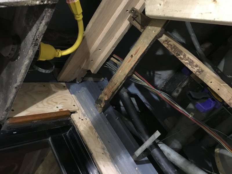

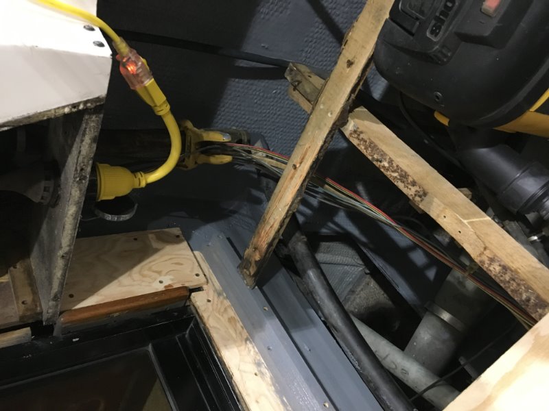

Finally A little more progress. I installed the two starboard and portside deck beams that had rotted out pretty bad. Does anyone know how the aft ends of these were supported? I can't figure out if the attach to the vent box or the transom. Next will be laying the decking with 3/4" marine plywood
