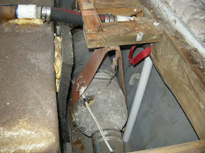

Look at the way the exhaust is mounted. It is hanging from a cross member with some type of strap. Is this a normal way of mounting ? I am thinking I should probably change this. The port side (second pic) is the same, only the frame that it is hanging from has no support !

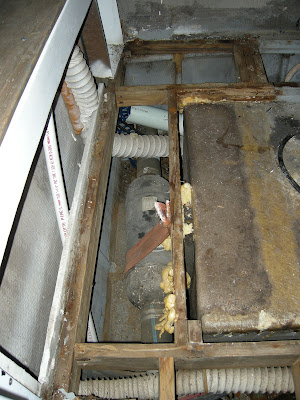

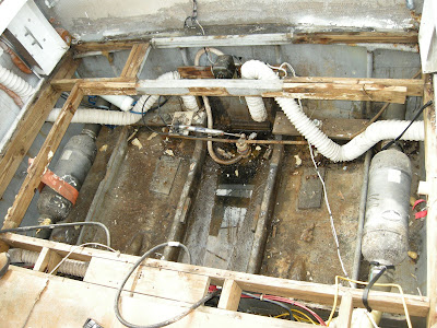

I removed the rest of the deck in prep for the removal of the tank. Here is a pic of the starboard side. You can see part of the fiberglass tank.
